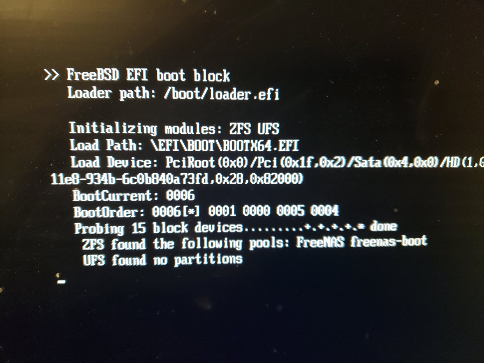

Won't boot after power outage. It's starts but... stops. I've attached a picture of the screen.
Please help!

Oh and out of curiosity... at what is it stopping boot @ ... it seems to find pools but ...then nothing.... what would it normally do next?

ok I dunno... I re-installed on the ssd... rebooted and removed "installation media" as requested...and I ended up back at the same point I was with my original picture... :(
