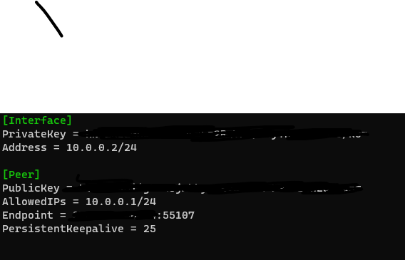

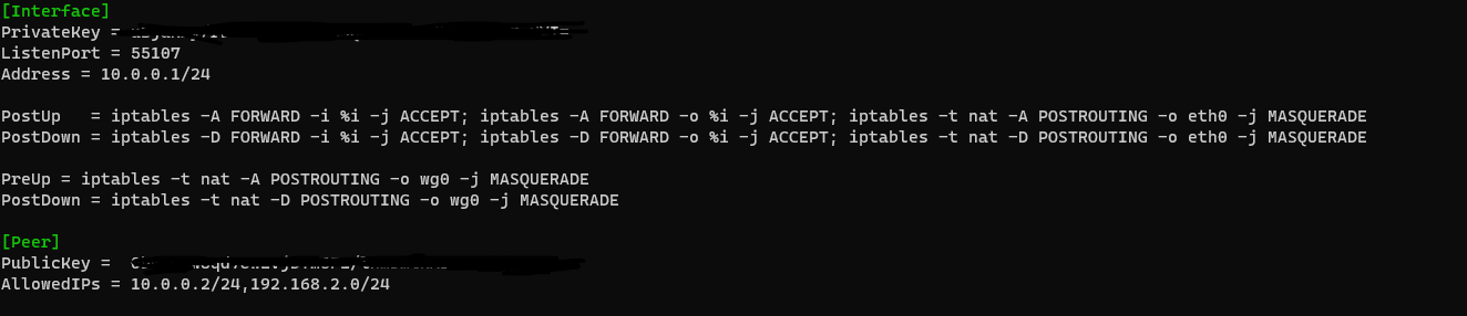

Reupload without sensitive information:
TrueNAS wg0:
VPS wg0:

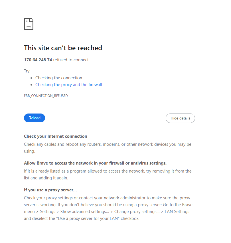

Thank you for your replies, here is my error code I get when trying to access the plex web GUI via public IP:
