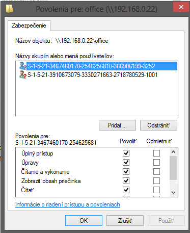

Hi, i want ask, if anyone know, when will Cyberjock release his tutorilal for public? Im stuck with my settings CIFS permisions and i need some good readings.
Have many problem with settings permissions for user, group that it can only RWX and cannot do changes in windows permissions, also i dont need everyone, next problem is, that i dont know how to setup newly created files and folders to inheritate permissions from dataset (setfacl). Now i have problem with log message "possible deathlock - trying to lookup SID" - this applyes to group (i try recreated with same id and other id, nothing work). Next questions for me, why i dont see name of users and groups in windows clients and how to setup ACL from CLI (SSH)....

marian78
Jun 30, 2011
210
hi, i read this thread before, but there is no permanent solution for deathlock (cant find them, there is only one solution that works until reboot your server). But my bigest problem is, that i use Windows ACL and i cant properly, secure set permissions for sharing. By default all shares have "everyone" and users that have access to share can made changes to ACL in windows clients. And newly created files and folders in that "default" shares not inheritate permissions (i remove "everyone" from root share, but new folders and files have it again). Next another problem, how to setup from windows cleint permissions on CIFS shares setup as "not browsable" ???? And next question, how to setup permissions in windows client on 10TB share?
