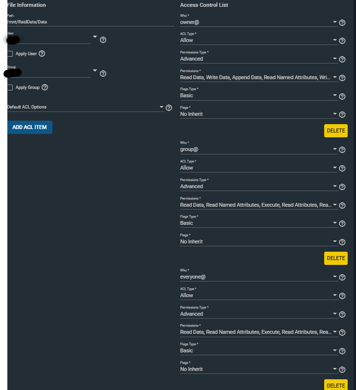

Is this an ACL issue due the the changes made in 11.3 to Samba and ACL's ? If so, what/how should I change the ACL information through the web interface. Do I need to apply ACL permissions recursively or strip ACLs? Both these advanced options sounds dangerous with potential disastrous consequences for the novice like I am.
Or is there something that I need to change in Windows 10 (1903.18362.1082) Interestingly, a check with Windows XP Pro doesn't seem to have any problems.
I am connecting to the Samba share with the user name in the ACL.
The owner ACL has all permissions checked except "delete" and "delete children".
Group and Other have read and execute access.
I don't recall editing the ACL's, after the upgrade to 11.3. In fact, I think I should be giving the group write access to the share as well.
