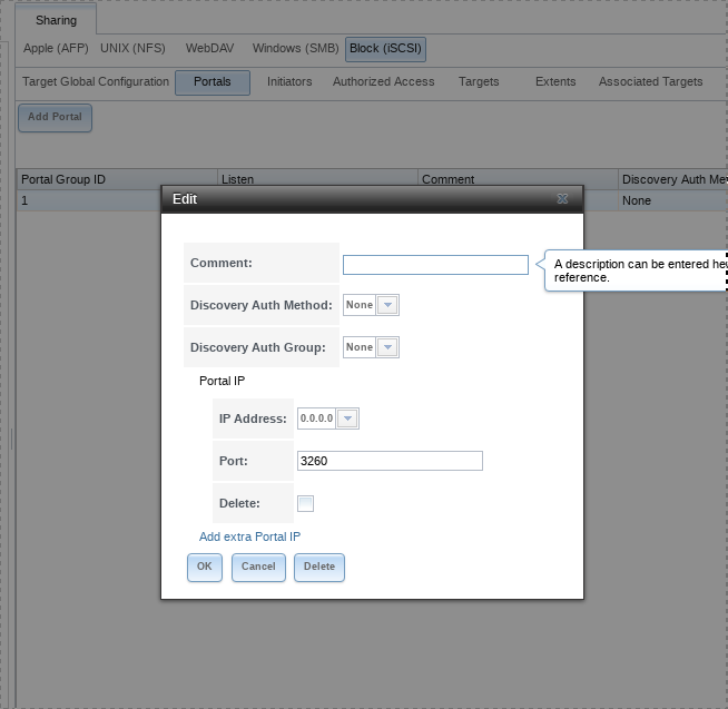

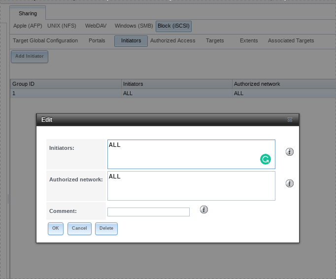

Finally tracked down my issue and was able to recreate it. I was 1000% wrong it is not a driver issue but a config issue in freenas. You need to setup a portal and an initiator for it to use. Look under shareing -> block (iscsi) -> portal or initiators.
you can just add both as defaults but here are mine
LMK if this doesn't fix your problem

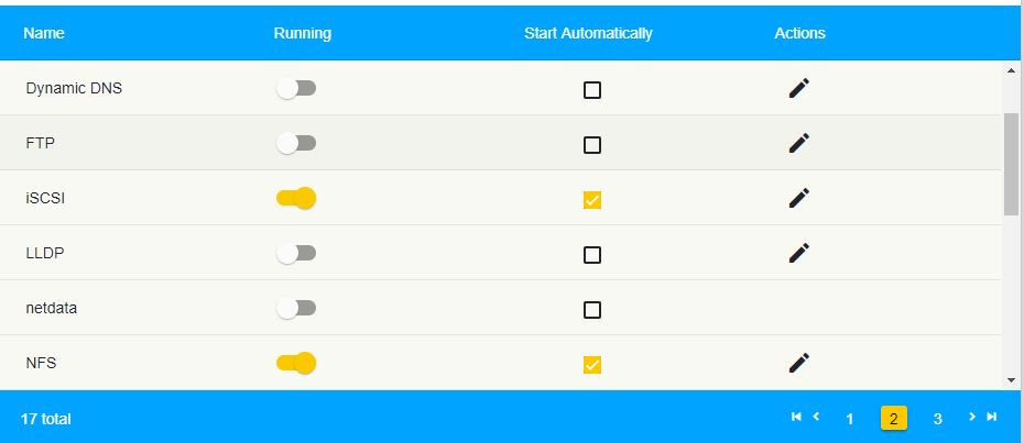

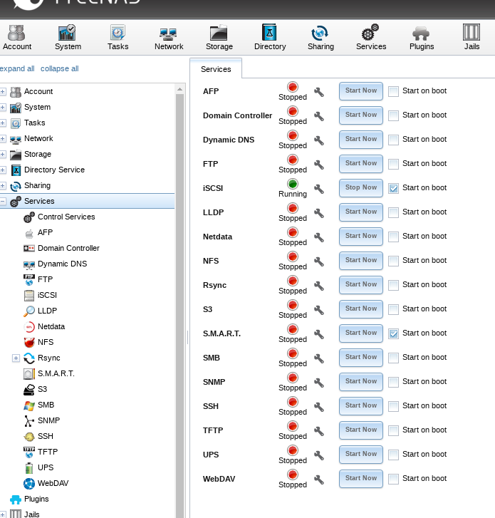

The service is running:

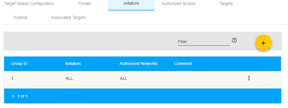

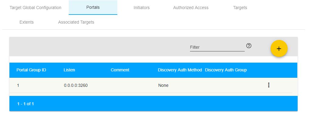

And i have created the Portals and Initiators config:

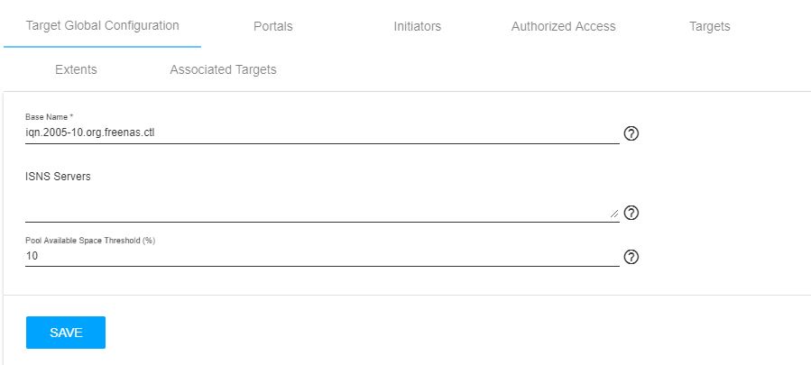

Finally the only other item that has configuration data is the Target Global configuration:

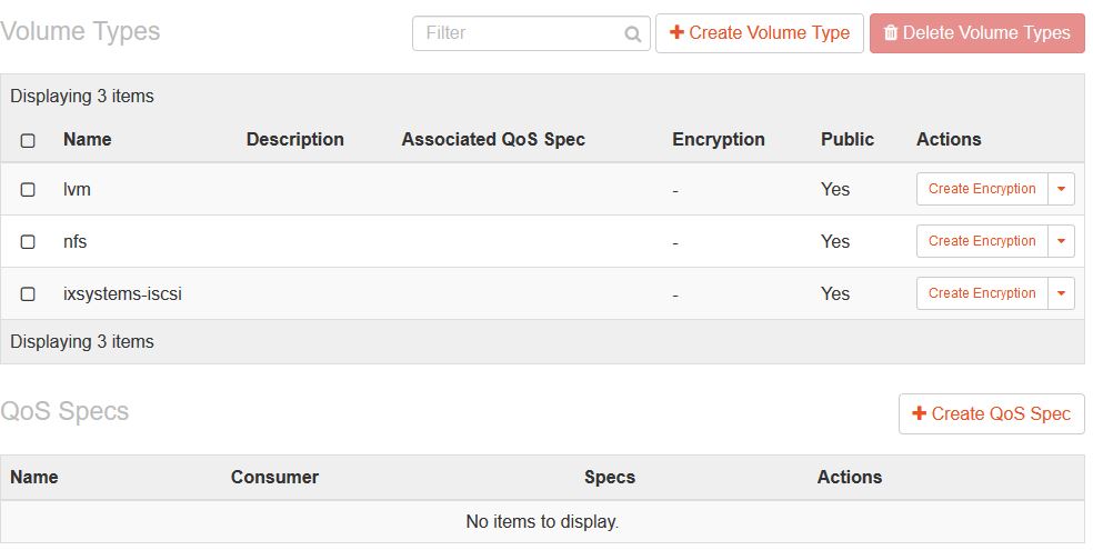

Side notes: I have a config that serves NFS, LVM and iSCSI for testing purposes. In openstack each of the items is directly coupled to a Volume Type. So they are not grouped. The account used to connect to the Freenas server is the root account. I know this is a big NO in production, but i used it to rule out any restrictions on the account side.
Openstack Volume Types:
If i create a volume in Openstack, it creates the volume on Freenas as a zvol. Example: volume-29e32973
Something is doing what it is supposed to, like you also expected it to.

Beholder101 I have good news and bad news. Good news is you are not crazy. The bad news is the driver does not seem to work with 11.2 beta2.
I install the beta i could not create volumes but just got the 409 conflict as you do. I switched back to a freenas 11 stable install and everything works fine. Both freenas environments were fresh installs into kvm vms.
I think if you switch to using the 11 stable build all your issues will go away and openstack cinder will work as you expected.
