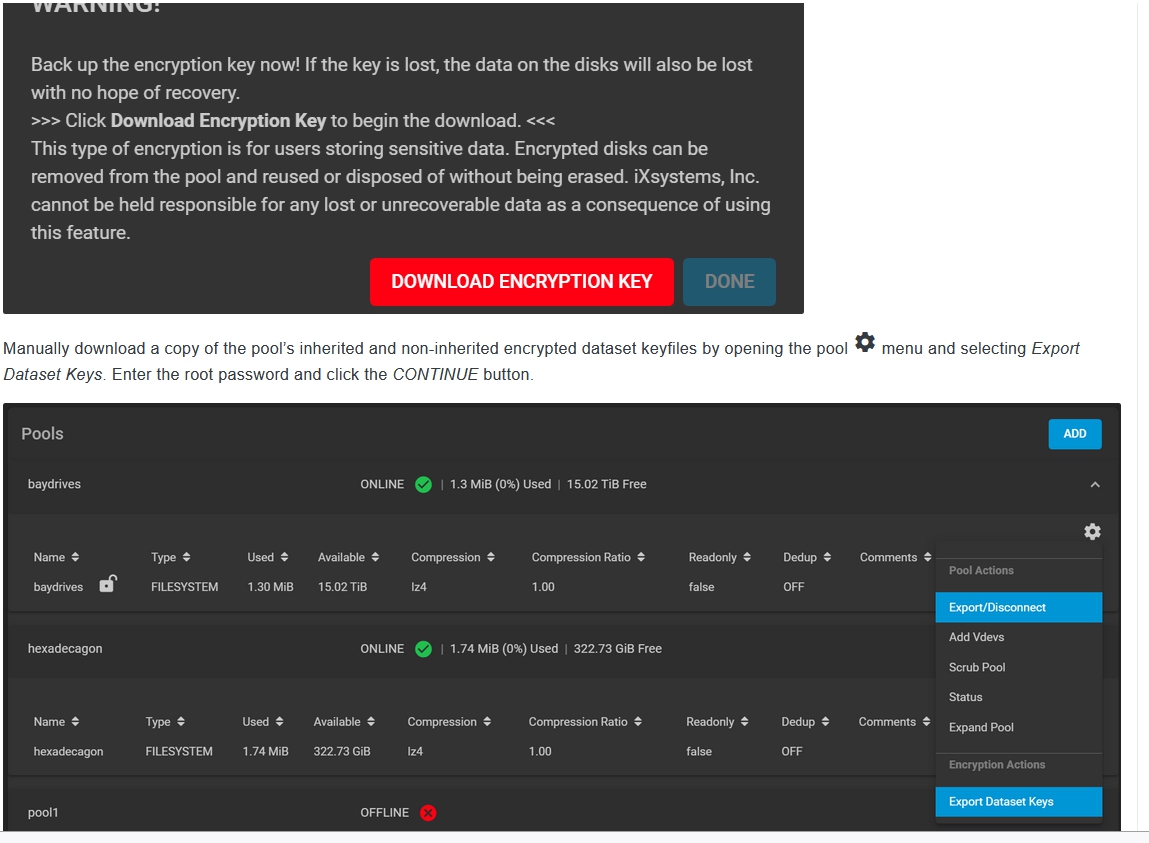

I just noticed this page of documentation:
https://www.truenas.com/docs/core/storage/pools/storageencryption/#encrypting-a-new-dataset
It concerns saving a 'keyfile' when you encrypt a data pool. Having done just that, and wanting that pool to be protected come a total drive failure, I'm unsure if the snapshots mentioned will be sufficient. Looking at this part of the above page...
I realise that I did not 'DOWNLOAD ENCRYPTION KEY' when the pool was created. No matter apparently, since the documentation says I can do so now. Hmm. Unfortunately, the current GUI does NOT have the menu option indicated here. There is NO "Export Dataset Keys" anywhere that I can find. Has this option moved? Is there a new way of getting a set of keys for safe keeping? Do they form part of a snapshot instead now? All insights gratefully accepted!

No, ZFS snapshots do not include the encryption keys. I don't know how to download the encryption keys. But, it should be possible and you WANT to do it, (in addition to saving your NAS' configuration).
