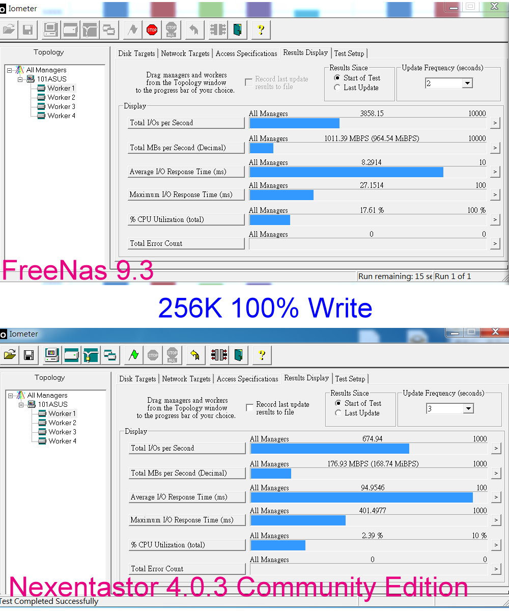

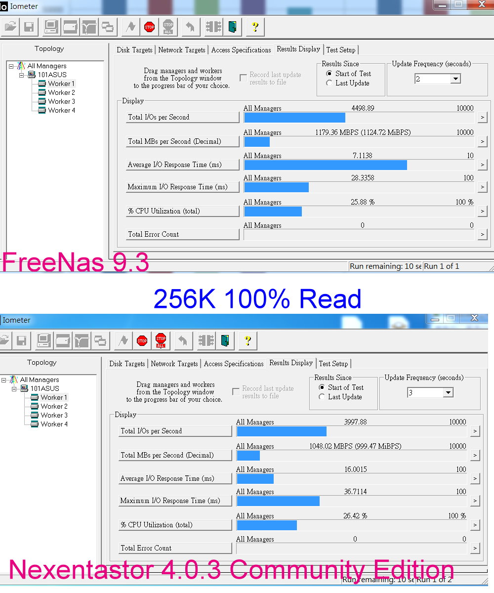

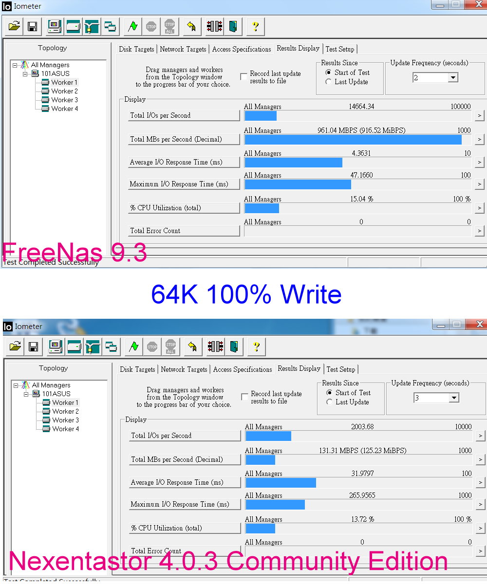

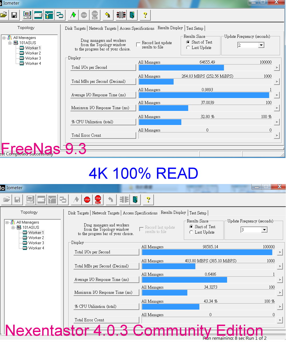

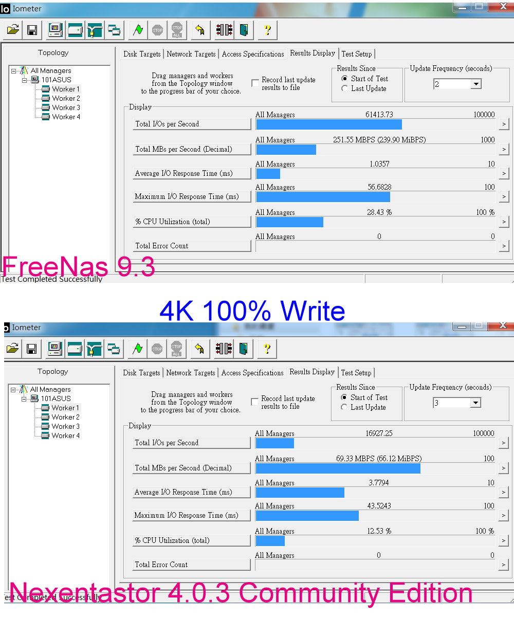

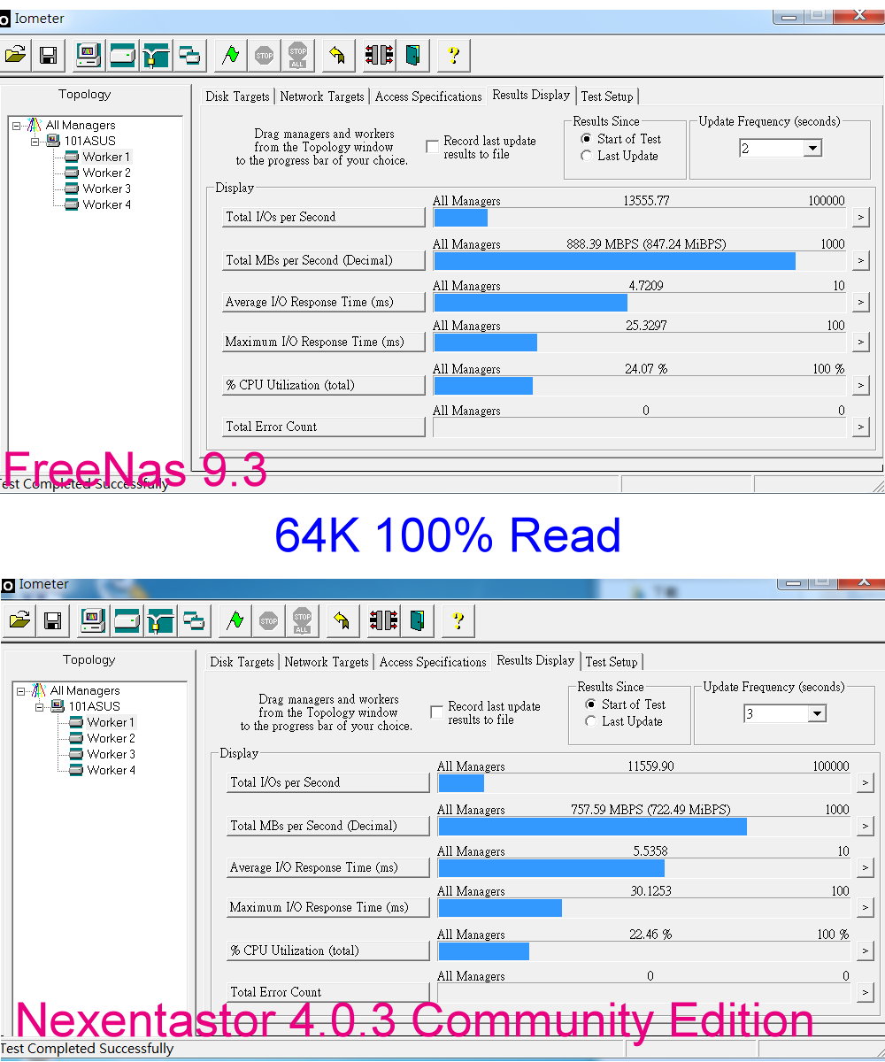

I've made a simple benchmark with FreeNAS-9.3 and NexentaStor4.0.3 community Edition
Using Zfs and ISCSI services
Server Hardware: i5-2320 ,4G ram, SSD *2 (stripe)(Toshiba Q-series 256GB),Intel X520-Da2
Client Hardware & OS: i5-2320 ,4G ram,7200 RPM HDD,Intel X520-Da2, Windows 7 32bit
Benchmark Software : IOMeter 1.1.0 without any tuning
4k 100% Read
4k 100% Write
64k 100% Read
64k 100% Write
256K 100% Read
256K 100% Write
the benchmark data looks a little weird , i'm just wondering which is better for kvm storage pool....any advice?
