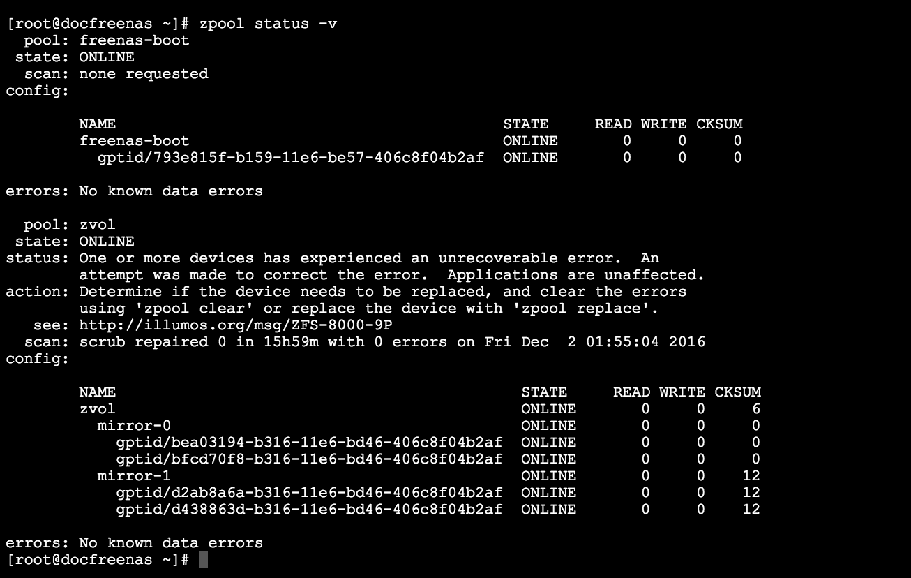

I got another error today after doing the second scrub. I think it confirms that the USB/FW were the cause (not that any of the other factors were any good).
A heartfelt thank you to all who have replied. I will do more reading before i set up a less ridiculous test.
Measuring by lessons learned, this test was a success :)
Any chance you can pin it down to one or the other? Which vdev is on USB and which is on FireWire? My hunch is that FireWire is more reliable than USB, but that's probably just my inner Apple fanboy. Also, it could still be the disks. What make and model are they? Any chance you can run badblocks destructive on those two disks, just to eliminate that possibility?
Agreed, this would be a good place to direct others who are considering using <whichever connection is flaky> in production.
Hmmm, that could be fun to find out. I will run badblocks monday.
