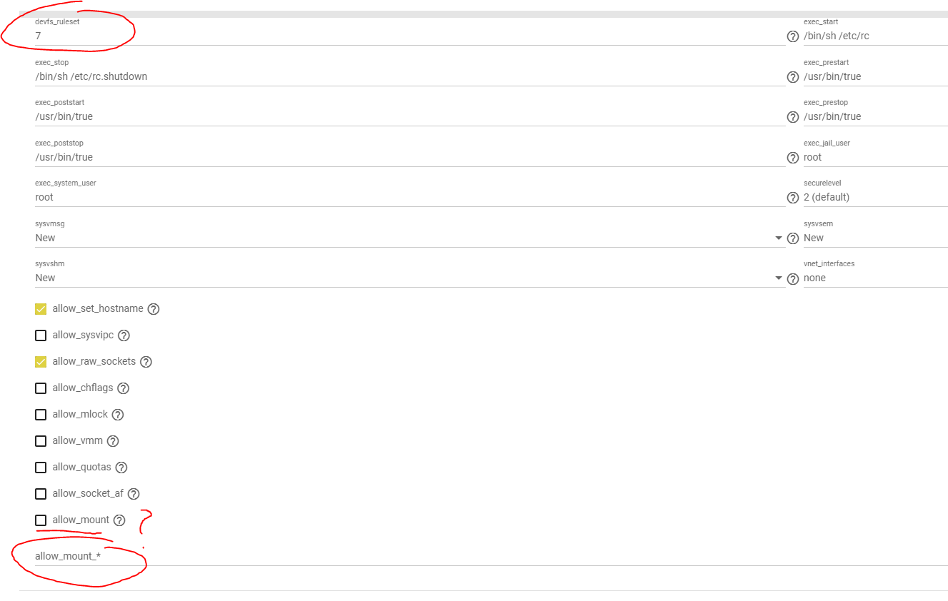

Some of my Jails throw an error when I start them, for example my Jackett Jail gives this message when starting:
Ruleset 6 does not exist, using defaults
I currently have 7 Jail running and each of them have a different value for this property. I don't think I've every configured it when creating these Jails.
Why do all my Jails have a different value and why do I sometimes get this error?
How can I determine what the correct value should be. I've looked at the documentation but it doesn't provide much explanation.
  • Jackett Jail devfs_ruleset: 6 (message that ruleset does not exist on start)
  • Plex Jail devfs_ruleset: 7 (message that ruleset does not exist on start)
  • Radarr Jail devfs_ruleset: 9 (no message)
  • SABnzbd Jail devfs_ruleset: 8 (message that ruleset does not exist on start)
  • Sonarr Jail devfs_ruleset: 10 (no message)
  • Tautulli Jail devfs_ruleset: 11 (message that ruleset does not exist on start)
  • Transmission Jail devfs_ruleset: 4 (no message but when I start it says that it's using devfs_ruleset 5)
Some other weird things. When I stopped the Plex jail it said it was using devfs_ruleset 8 when 7 is configuration. And when I start Transmission it said it used devfs_ruleset 5 but configured is 4.
Can someone makes sense of this for me and should I be worried about this? I'm asking this because I'm trying to disable IPv6 for my Transmission Jail and some search results have shown me comments relating to devfs_ruleset settings. So far I've also been unable to disable IPv6 inside the Transmission Jail.

Update for this topic. I just updated my FreeNAS server to TrueNAS Core 12.0-U1.
My Jails are still on 11.4-RELEASE on the latest patch level. When I tried to start my Plex jail I got the following error:
# iocage start plex2
No default gateway found for ipv6.
* Starting plex2
plex2 devfs_ruleset 7 does not exist! - Not starting jail
What should I change in the Jail configuration to make it work again, can I just put the devfs_ruleset to 0 for all Jails?
Are there any other settings I need to change here?
And how can I get rid of the ipv6 error message?

Just an update that I've since upgraded to TrueNAS 12.0-U1 including upgrading all my Jails to 12.2-RELEASE at the latest patch level and based on some talks I've had on Discord I set the devfs_ruleset value to 4 for all my Jails and haven't seen any warnings or errors anymore and all the Jails seem to be working well.
When I start a Jail now it uses a number above 1000 with incremental increase and when I shut down a Jail it removes that ruleset again. I still have no idea what this setting actually is aside from some a general understanding that this determines what kind of devices the Jail can access.
To get rid of the IPv6 warnings/errors during the starting of a Jail I changed the following settings on all my Jails:
  • Under Basic Properties: wrote in none for IPv6 Default Router.
  • Under Network Properties: selected Disabled for ip6
9,700
It's exactly that... the /dev is selectively mounted with access restrictions based on the rules in the set.
You can see more about it in the manual (https://www.freebsd.org/cgi/man.cgi...opos=0&manpath=FreeBSD+12.2-RELEASE+and+Ports), but to shortcut that a bit, here's a few pointers.
devfs rule showsets
devfs rule -s 1001 show (assuming rule 1001 appeared in the output from showsets)

Thanks for this Mannekino. Just upgraded to 12.0-U1.1 and my Jail wouldn't start. Was set to devfs_ruleset 5 and choking. I changed to 4 and also disabled ip6. Up and running again!
Thanks!
