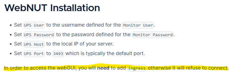

After some research i found the truechart's installation notes for this app where they indicate
This would explain why it does not load. Do any of you know how to set up "Ingress" in this app to make it work?
My understanding is that this is a way of using traefik as a reverse proxy for this application but i would like to avoid doing this if possible as i already use a different reverse proxy for all my other apps (HAProxy in PFSense). Having to pay attention to 2 reverse proxies would be less than ideal for me.

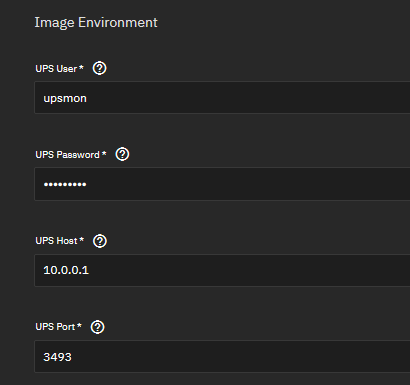

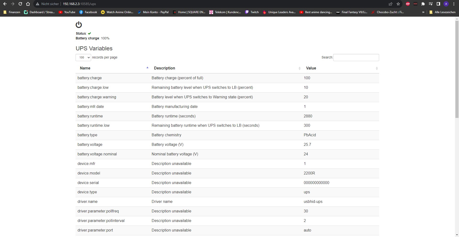

ok i only filled out the fields for:
UPS User
UPS Password
UPS Host
UPS Port

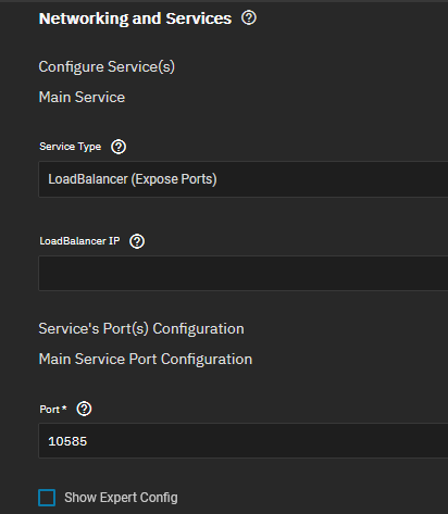

and for networking and services:
Service Type : Loadbalancer (expoese Ports) (should be the default value)
and Port is 10585 (should be the default value)
Ingress is not enabled and i can reach the webui with myip:10585
the rest is set to the default values.
Edit

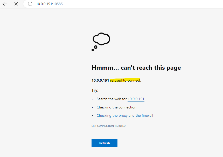

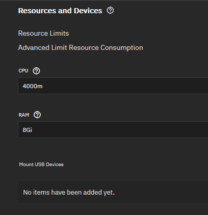

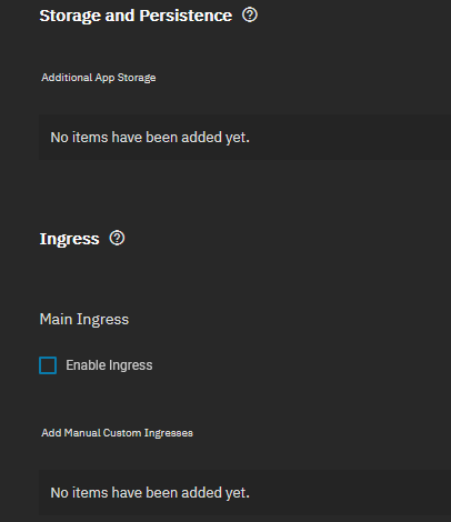

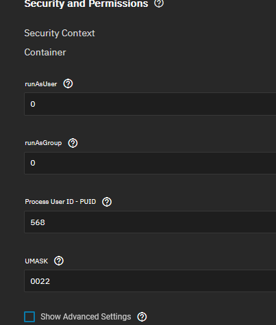

@LarsR thanks for the input but my settings are just like yours but for some reason it is not working for me.

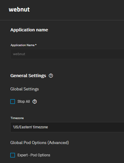

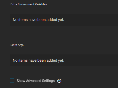

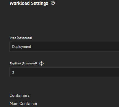

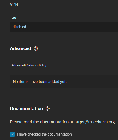

The following are my settings:
One thing that may be different in my environment than yours is that i set NUT as slave in truenas. The UPS is connected and monitored by my PFSense firewall which is set as the NUT server. The firewall has an IP of 10.0.0.1 which is the IP indicated as the "UPS Host", while my truenas host has an internal IP of 10.0.0.151.

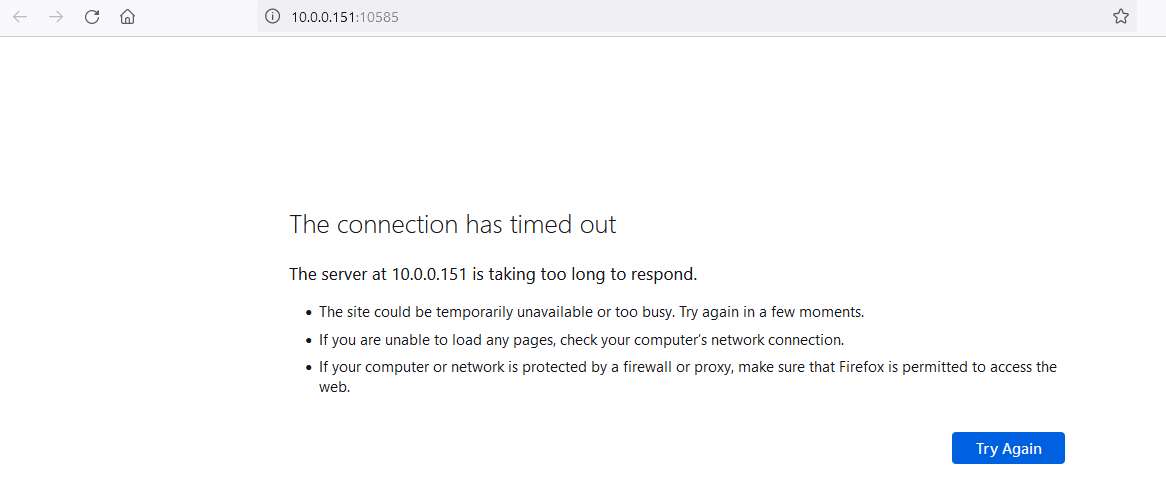

With these settings the App deploys without error but when accessing the web interface at http://10.0.0.151:10585 the connection time out and i get a error from my browser
Do you happen to have any other pointers of things i could to try?

Ok, I deleted the app and reinstalled it.
Now it is magically working, no ingress necessary.
Why is it working now and not before is beyond me. Thanks for the help @LarsR
