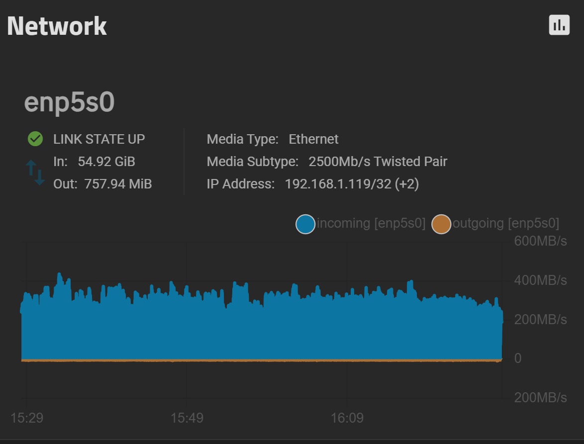

Web admin GUI showing transfer speeds in excess of 200MB/s but according to Goodsync the actual speed is closer to 30MB/s

I am a bit confused by the performance metrics displayed by the Network section of the dashboard.
According to the chart, the back up transfer speed averages well over 200MB/s but in reality the back up process is actually only sending 30MB/s to the TrueNAS server.
Am I reading the units wrong, is this actually 200 mega bits per second? I thought that the convention was upper case B to denote bytes and lower case b for bits.
Thanks.
Ben

tmacro
Dec 6, 2023
I'm seeing this as well. The numbers reported in the In/Out breakout are completely nonsensical (10+GiB being reported for 3 LACP gigabit NICs). I think it may be treating the metric as `bytes` instead of `bits`, but sometimes it seems to far off to be that.
