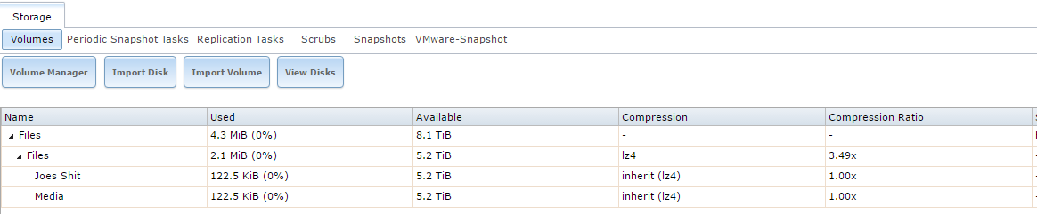

Hello,
Currently having a issue importing one of my volumes, if anyone can help would be appropriated, My systems currently is a Xeon l560 and 14gb ecc ram, 3 x 3tb running Z1 Raid, and a single 1tb drive (Which is the volume that i cannot import).
The volume itself does not matter to me, if I could relocate the data to Files would be fine.

Server_Pool is the volume I'm trying to get to import, however it does not show in the volumes list through the GUI and I cannot access the data through the shell.
Zpool import is blank, as the volume seems to be imported but not correctly.

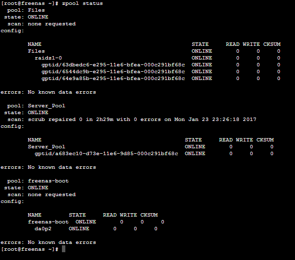

Yes I have tried that, the volume becomes unmounted after reboot, When remounting the volume through the GUI it does the same as before.
And no other errors in the logs or in zpool status?

There is no new errors besides trying to import through CLI shows "cannot mount '/mnt/Server_Pool/Files': failed to create mountpoint", everything else is the same with no errors.

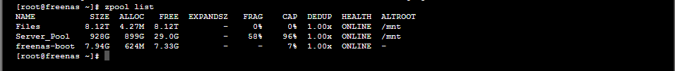

SweetAndLow
Sweet'NASty
Nov 6, 2013
6,421
According to the initial screenshots, Server_Pool is completely full, which is consistent with this:
Yeah that explains things better.
Try removing some data. If rm doesn't with you will have to truncate the files with echo "" > filename

I'm unable to access any data on the dataset, since all my files are in Server_Pool/Files and is not accessible I cannot delete, see or access files to make space.
I'm not sure if there is another way to have access to files so i can use Echo >>"" as i cant see the files to do this with.
The device says it has 29GB free using Zpool list, is it possible to use this somehow ?
This happened when I was rebuilding the main pool of Files to Z1 raid instead of stripe and was going to upgrade to Freenas 10 beta but i ended up staying with 9.10, this drive Server_Pool was used as a temp storage for my files during this process and when i finished and tried to access data using the new install of Freenas9.10 this happened.

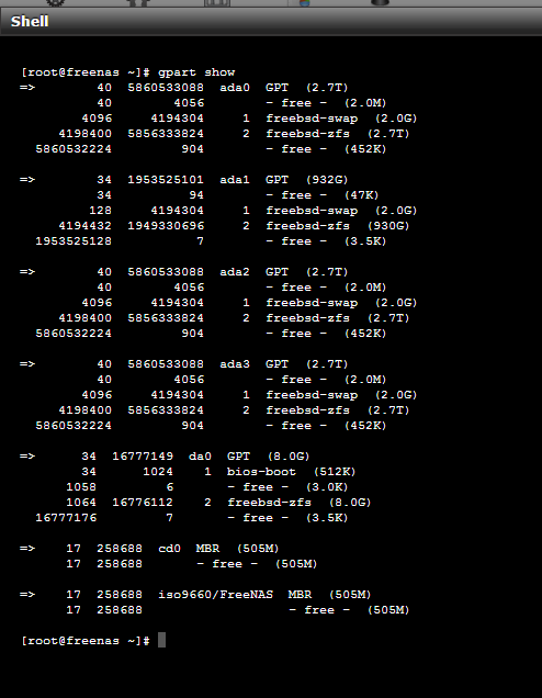

joebus
Feb 13, 2016
11
Here is gpart show of the devices, I'm not sure why the device is full when I think it should still have 30gb free ont he system.
Ada1 is the Server_Pool device .
