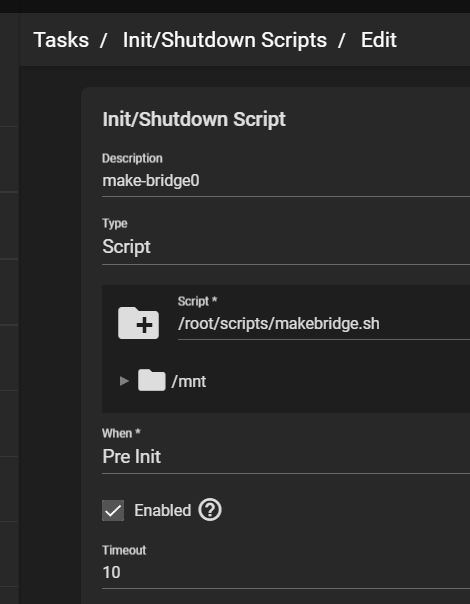

Finally managed to make it work. Quite a journey for a simple static IP address. Perhaps someone can recommend an easier method to others who read this.
Created a pre-init script here to re-create the bridge on each boot:
# cat /root/scripts/makebridge.sh
#!/bin/bash
ifconfig bridge create
ifconfig bridge0 addm igb0 up
ifconfig igb0 up
ifconfig bridge0 inet 172.0.123.123/24
and followed some of the tips from this post to set the jail interface to vnet0:bridge0
Easily my favorite way to spend a Saturday... :smile:
