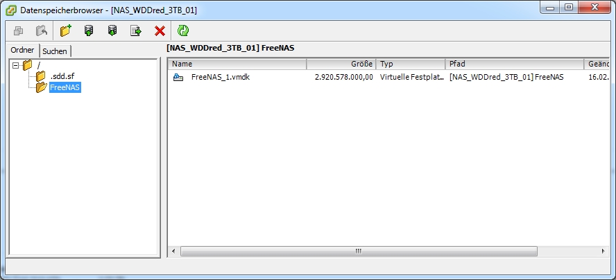

I have a little Problem with my NAS.
My freenas software is (was) running on a virtual machine - vSphere Client 5.5.0 (build 1618071) and EXCI 5.5.0 (1623387)
Hardware consists of
The storage devices are 2 WD reds 3tb (WD30EFRX).
I am realy not sure what raid system i used :(
I guess (!) it was raid z because it was recommended, when i build up the raid.
It worked fine for about 1,5 years. Then suddenly, when i am trying to boot the server vmware says:
"VMware ESX kann die virtuelle Festplatte '/vmfs/volumes/536a92d5-eaec0bd2-a675-002590d4c518/FreeNAS/FreeNAS_2.vmdk' nicht finden. Stellen Sie sicher, dass der Pfad gültig ist, und versuchen Sie es erneut.
Einschalten des Moduls DiskEarly fehlgeschlagen. "
I am not able to start the freenas-operation-system, while one of the storage devices is damaged (or the file is missing)?
How am I supposed to know whats wrong with the system, if i am not able to boot.
When I try to look for the missing data (FreeNAS_2.vmdk) it seems the HDD is empty. File "FreeNAS_1.vmdk" located on the other HDD is still there.

first of all. Sry for my bad language. English is not my foreign language :)
- SUPERMICRO X10SLM-F
- Intel Xeon E3-1200 Serie E3-1230V3 (shared 2 cores in VM)
- Kingston ValueRam EEC 8GB (shared 4 gB in VM)
So my questions are:
- Is there any way to restore the data? Especially my Photodata :(
- Is it possible to boot up the software form a standalone pc without the virtualisation?
- Am i able to see the data from the WD-Red-HDDs on a simple computer just for checking if the data is damaged?
hecky
