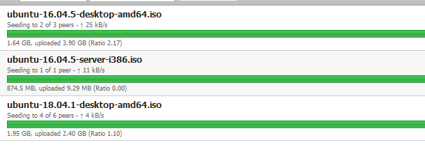

kennis942
Oct 4, 2018
21
i have problems with these versions of ubuntu including Arch linux. same error. Current Train: FreeNAS-11-STABLE (...)
