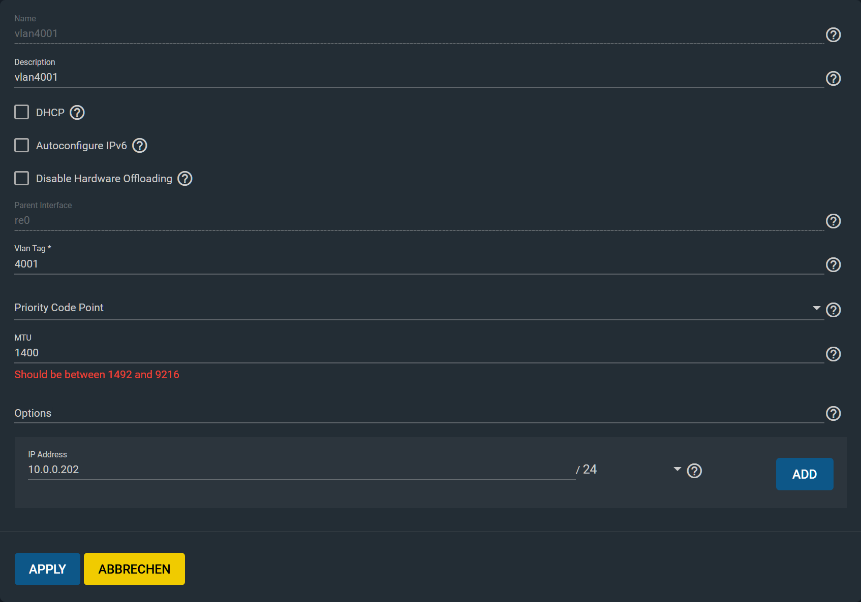

Hello All,
the Hetzner VLAN need a MTU 1400 Size.
I can only set 1492 as minimum.
How can i set 1400?
Version: FreeNAS-11.3-U3.2

re0: <RealTek 8168/8111 B/C/CP/D/DP/E/F/G PCIe Gigabit Ethernet> port 0xe000-0xe0ff mem 0xf0004000-0xf0004fff,0xf0000000-0xf0003fff irq 16 at device 0.0 on pci3

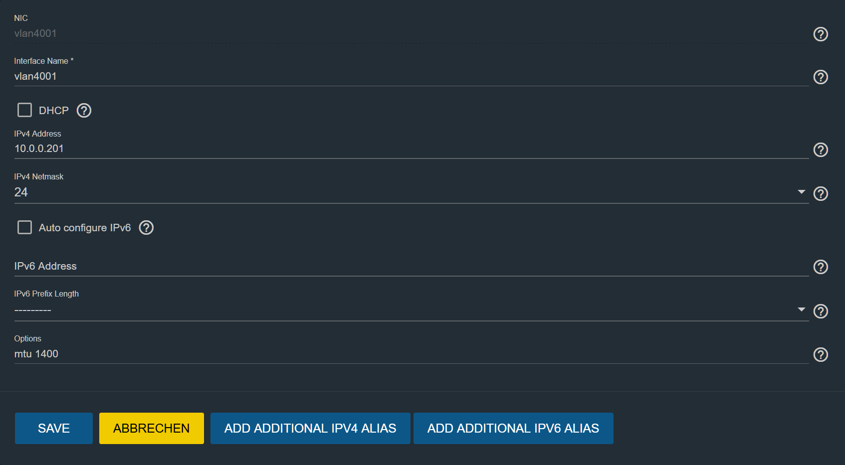

- VLAN MTU
i can set the 1400 Size under FreeNAS-11.2-U7 without any issues.

Unfortunately, this limit of 1492 for option mtu appears to be hard-coded in /usr/local/lib/python3.7/site-packages/middlewared/plugins/network.py, line 708, in FreeNAS 11.3.
Option vlanmtu is NOT restricted. You'll need to set option vlanmtu 1400 on the parent NIC re0.

Alternatively, you could create a post-init task to ifconfig vlan4001 mtu 1400.

Hello Samuel,
if i set it via Options, the Server goes offline.
The post-init Task works fine!
Thank you so much :)
