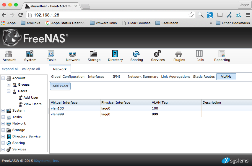

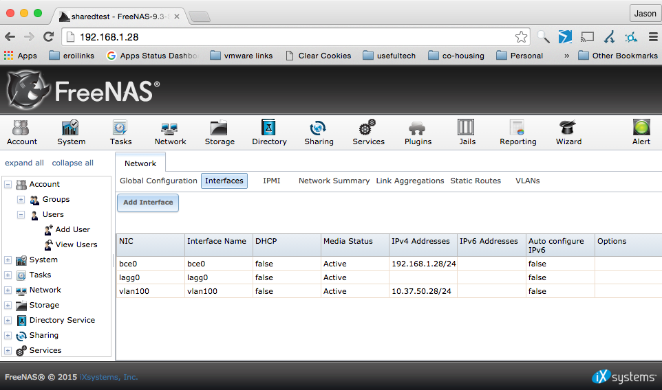

Note how vlan999 and vlan100 switched places. The vlan screen did not change but here's a screen shot of the configured interfaces:
So if my configuration is wrong, I would be happy to fix it but it's not at all clear in the documentation how to do this, and it appears something is wrong with how the gui is configuring freebsd.
