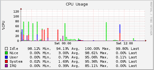

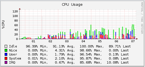

Did the upgrade to 9.2.1.7 via the webui on my box on Tuesday early morning. Specs for the server are : Supermicro mobo with dual Xeon L5520 and 96GB of RAM. I'm running two jails, one for Plex and one for PlexWatch. After the upgrade I've noticed some very high CPU usage under the reporting section. I've looked on my plex setup and there has not been any abnormal usage or transcoding. Looking at the graph it seems that the update is likely to blame. Any debugging tips or should I roll back to 9.2.1.6 (and what is the best route)?
I've attached a graph of the recent high CPU as well as a graph of the normal CPU for comparing purpose.

Well I'll bring up two things.
First of all, why not turn off the plex jails temporarily (you can "stop" jails in the GUI), and see if this has any effect on the CPU usage? If your hypothesis is right, it shouldn't have any effect.
Second of all, I, too, did notice a change in CPU behavior when I went to 9.2.1.7. Now, mine was less dramatic---when I'm idle, I'm still idle. It's not like I went from nearly 0% CPU to always significantly non-zero CPU like you did, but, I did notice that the CX states on the CPU stay in a higher power state 2-3 times more than before I went to 9.2.1.7. (whoopdie doo---probably added 0.5W to my total power use---but still, something is different).
But before we blame the upgrade, let's rule out Plex. If there are 100 things that could be "Plex, or FreeNAS", experience shows that at least 98 of them will turn out to be Plex.
There's also been talk that Plex has been acting weird recently, so all the more reasons to remove it from the equation.

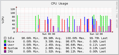

So it looks like the problem isn't plex related. I turned the jails off at the same time I posted yesterday. The rest of the day it looked like things were going well but looking at todays chart there are still abnormally high CPU spikes. Any thoughts on how to debug further? I wouldn't mind rolling back to 9.2.1.6. Should I just reboot the box and select the second boot option?

What you need to do is start looking in "top" when your system loading is going really high and see what it's actually doing. ;)

Tried to setup top to write output to a file overnight (so I could then cross reference high CPU times with the log) but can't seem to get the command correct. I SSH'd into my box and used tmux to open a new session. Planned on running the following command all night but the code doesn't seem to be working correctly.
top -b -d 10 >> /mnt/main/file.txt
It'll usually exit within a few iterations. I tried different permutations of the flags as well as adding "-n 100" to no avail.

Ok, so after going through the top log (outputted ever 2 seconds) overnight I cannot seem to correlate the graph spikes under the reporting tab with the top log. For example, if the graph shows a spike at 5:30 am the top logs show idle the entire time instead of the high usage the graph reports. Any way to only output top if the CPU usage is over a certain threshold? or maybe use grep to achieve this?
