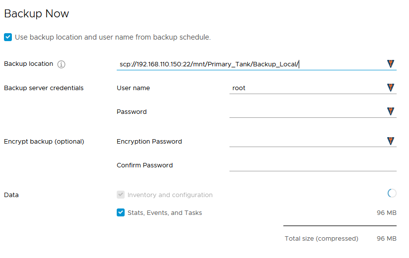

I am far from an SCP guru but I thought during an SCP session you could issue commands like chmod chown when changing permissings and owners? I'm thinking back to when i used to use winscp as a web host years ago. As far as I know its not mounting it on vcenter maching the configuration is just a regular scp like connection. see below:

I'm thinking back to when i used to use winscp as a web host years ago. As far as I know its not mounting it on vcenter maching the configuration is just a regular scp like connection. see below: View attachment 63709
I'm not familiar with vCenter so someone else will have to step in here, but from the logs, it appears to me that it appears to be doing some sort of mounting of your TrueNAS dataset within its local filesystem unless it is actually executing chmod on /mnt/Primary_Tank/Backup_Local through ssh on your TrueNAS machine.
