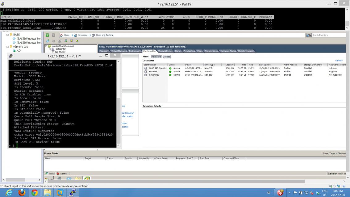

Has some work been done with this? I just installed FreeNAS 8.3.1-BETA1 and I noticed VAAI status is set to supported, but can't find anything in the release notes.

I noticed this when I installed 8.3.0.
After running some tests, it does not seem to work. With VAAI, cloning or deploying templates on vsphere/vcenter on the same storage (freenas) should be much quicker and should not utilize the network. From the observation from my test server the cloning and deployed templates the data show the data going out of the NIC and back into the same storage. I believe its a false positive for "Hardware Acceleration: Supported"

Would you mind running this on esxi?
And what is your freenas version?
esxcli storage core device vaai status get -d t10.bla bla
VAAI Plugin Name:
ATS Status: supported
Clone Status: unsupported
Zero Status: supported
Delete Status: unsupported
I want to see clone status / delete status is "supported".
