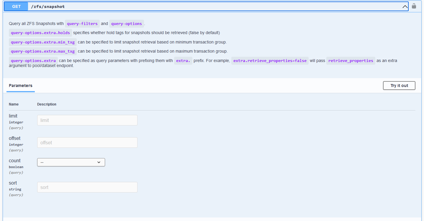

I'm using the zfs/snapshot API endpoint specifically, and I'd like to sort the resulting JSON chronologically.
What values does this parameter accept? I've tried "name", "date", assuming that it wants specific keys from the JSON data.
All of them come back with 422 Undocumented.

Bearing that in mind, what's the point of this "sort" parameter then? See the attached screenshot from the REST API documentation.
I don't see "order_by" referenced anywhere in those docs.

Hmm... that might be some broken documentation.
