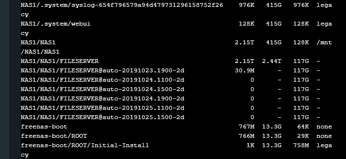

After that i creat a snapshot task to start the replication, a snapshot every 4 hours, with 2 days duration. I had a lot os spnas before correctly configure corretly the replication, but was no working well ( the other NAS was updating).
When it start work correctly is just deleted the snapshot that i dont need.
After that the system says i have at this pool/dataset 2.1TB used when i have around 200GB on the files on the filesever and figureout how i can now clear that space.
I just wondering where is my used space..

Are your trying to delete the snapshots you see in the posted pic? If you are unable to do it from the GUI, you can try from the shell.
zfs list -t snapshot
will list all snaps.
zfs destroy <volume>/<dataset name>@<snapshot name>
will delete a specific snap.

2.The screen are the normal snapshots that i want to keep, but 117GB x 6 will result in 1TB max usage, not 2.15TB.
3. I allready deleted several snapshots that had been created and the system stay with the same amout of used storage.
