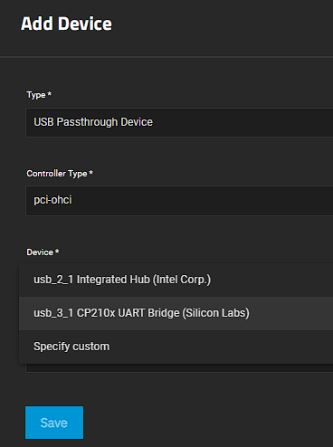

Hello,
I have a VM running linux (with home assistant OS on it), i want to connect it with a sonoff zigbee usb dongle.
The device is plug and it appear in the dmesg (see bellow) at usb 3-1.
But when i tri to add it to the VM it don't show up in the liste (screenshot below)
Can anyone please help me on this?

juless
Jan 3, 2023
10
the UART bridg appear even if the stick is unplug

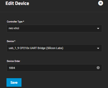

Referring to your other thread and seeing this is the proposed installation method I suggested, I should have mentioned I'm using the same sonoff usb stick.
For me it works, it appears in the list and I'm able to add it.

Mmh,
This is my setup.
You did shutdown the VM during adding the device? Did you try different ports?
You may want to reboot your server.
Adding to your other post, sudo lsusb the shell will often say command not found when it means you're lacking privileges. But if shows up correctly in dmesg and you can't choose it here it probably go for a reboot or change USB ports.

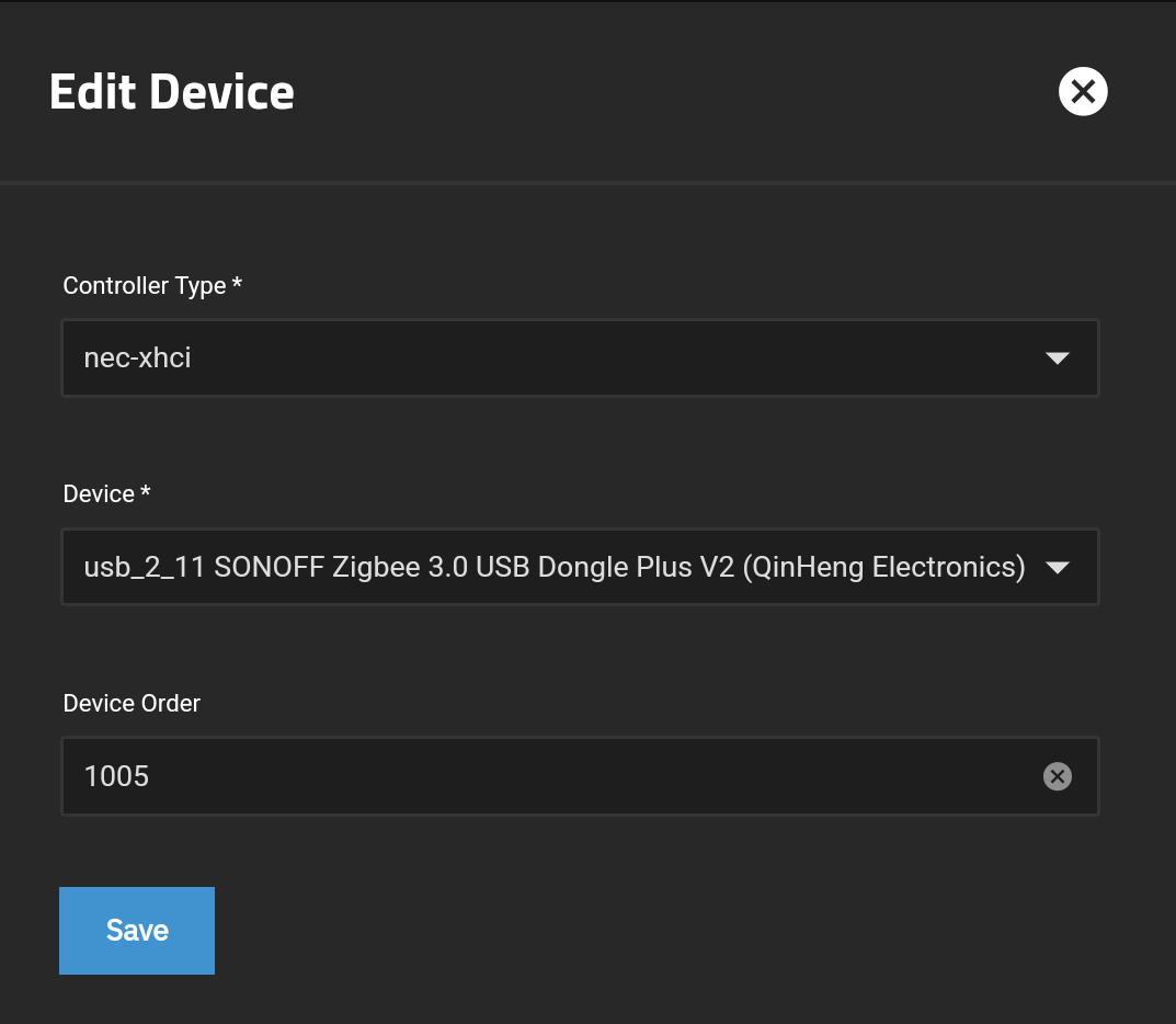

erlendfalch
Mar 29, 2024
I have Sonoff Zigbee 3.0 and experienced the same problem as above. But notice that the device got a different name than I was used to in HAOS. I found it by checking which device got added/removed from list in webui after connecting/disconnecting the dongle.
Added it as follows, which worked in HAOS:
