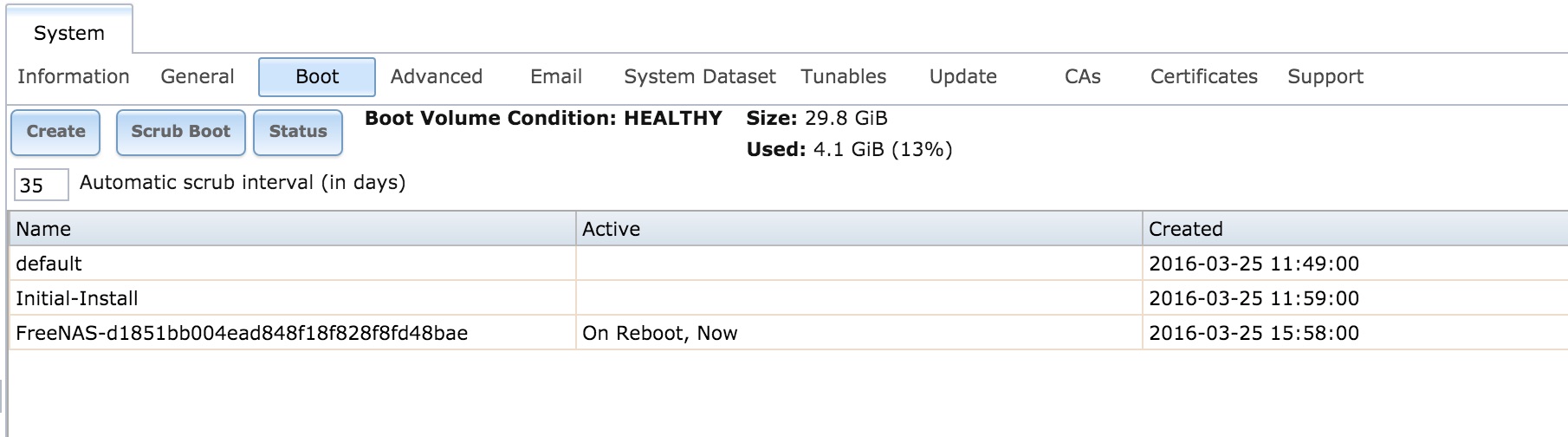

How many boot environments on on your boot device? The snapshots for updates will take up space.
san134
Jun 21, 2014
4
Currently I have only three (see the screenshot). I also had v9.10, which was taking up more than 95% of 16 GB USB drive. I selected previous image as 'active' then deleted the v9.10. The currently active image is also growing (it was 3.9 GB occupied last night and increased to 4.1 GB now). I guess something is filling up my boot drive. I cannot figure out what.

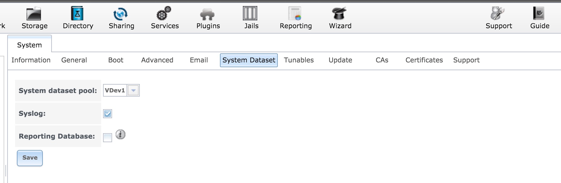

Please post a screen shot of GUI page:
System> System Dataset (tab)

@BigDave I have attached the screenshot
I also have 32 GB of USB takes about 2-3 weeks to fill up.

BigDave
FreeNAS Enthusiast
Oct 6, 2013
2,479
I am not using "reporting database" option in freenas setting
Even if you were, the information icon for the Reporting Database reads;
"Save the Round-Robin Database (RRD) used by system statistics collection daemon into the system dataset"
The system dataset defaults to the main zpool, with the option to write it to the boot pool, the OP and san134
both state their chosen setting is main pool, not boot pool.
This whole thing is strange, having eliminated the System Dataset thing.
I can't begin to even guess as to what process could possibly be writing to the boot pool.
You don't suppose the Devs switched the System Dataset over without telling anyone?
Nah, there would be many more complaints....
It's gonna take someone smarter than me to get to the bottom of this one.

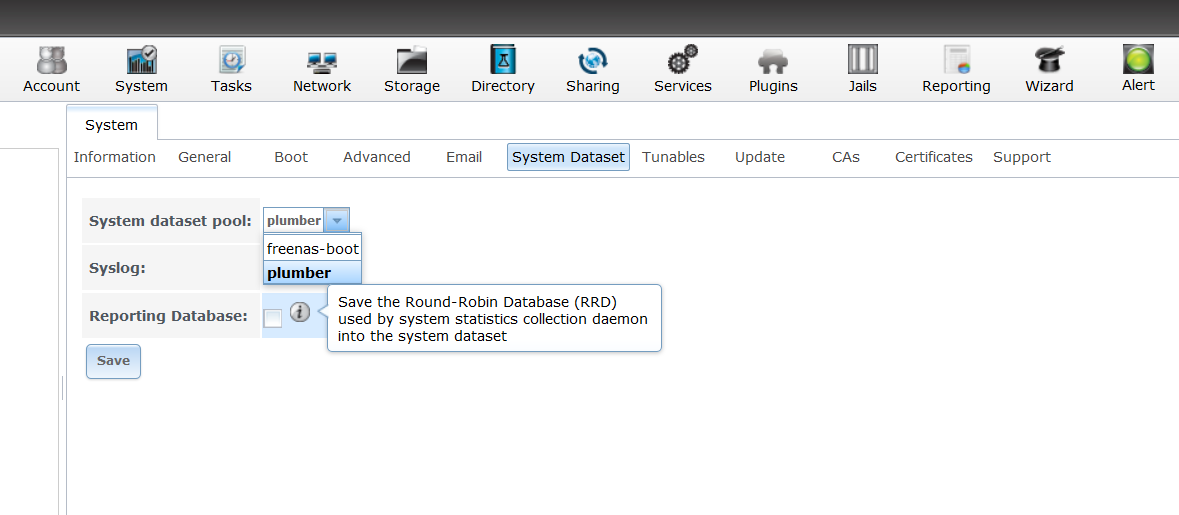

pirateghost
Unintelligible Geek
Feb 29, 2012
4,219
There is no option there to write it to the boot pool. Writing to the boot pool is the default option.
Why are they not using standard UNIX utilities like 'du' to find where the space is going? Using 'du' will show right where the culprit is rather than us just sitting around guessing.
BigDave
FreeNAS Enthusiast
Oct 6, 2013
2,479
I've never touched the System Dataset option on my server,
afaik it's always been on my configured pool, not the boot pool.
BigDave
FreeNAS Enthusiast
Oct 6, 2013
2,479
Makes perfect sense to me, if FreeNAS can only find the boot pool, it creates the System Dataset on that boot pool.
Then once you configure a volume, the option becomes available to choose between the two pools.
Thanks for clearing that up for me pirateghost.
I wonder if chosing the main pool for the System Dataset would stress the USB flash drives less and cause them
to exhibit fewer failures?
