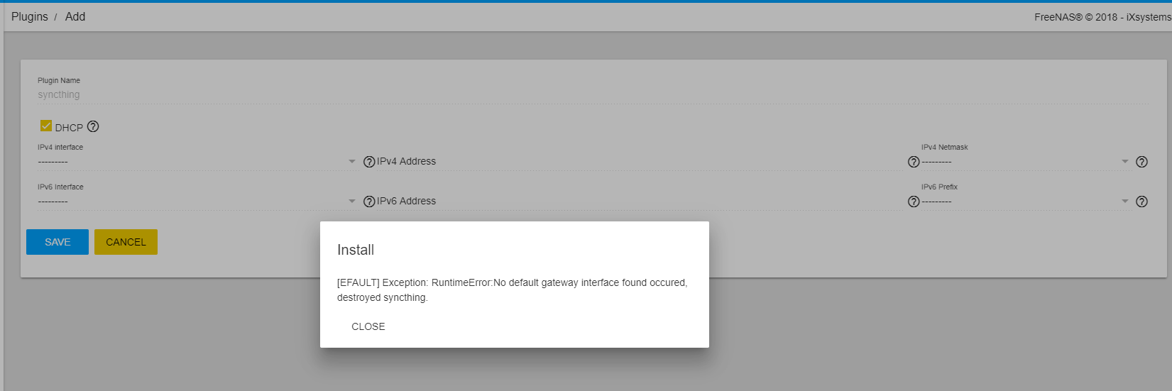

<urlopen error [Errno 8] hostname nor servname provided, or not known>

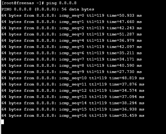

Sounds like either your DNS/nameservers are not set correctly, or your gateway is not set correctly.
Drop to shell.
If you can ping 8.8.8.8, your gateway is working.
If you can type "drill google.com" and it resolves the IP address, your nameserver is working.
If either of those is not working, fix that in the network screen.
Drop to shell.
how can I fix the gateway that's what is broken

Go into the "NETWORK" part of the user interface, then "GLOBAL CONFIGURATION", and look for "IPv4 Default Gateway". The IP address in there should be the IP address of your router. If you don't know what the IP address of your router is, you can google "how do I find out what my router's IP address is" for your appropriate operating system (Windows? whatever).
If *THAT* still does not work, please let us see the output of "ifconfig" in your FreeNAS shell, post it here.

thank you i think its fixed
