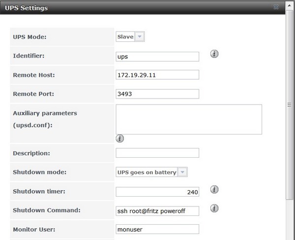

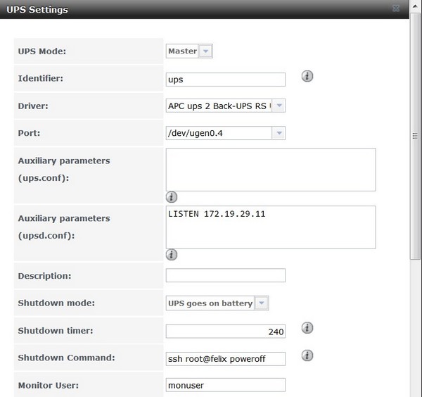

If you power multiple servers with a single UPS, as I do, you must connect one of them to the UPS with an appropriate USB or serial cable and configure this server as the Master. Be sure to specify the server's IP address in the upsd Auxillary parameters section for the UPS daemon to listen on. This provides a communications link between the Master and the other servers on your network powered by the UPS. Configure these other servers in Slave mode, specifying the Master's IP address as the Remote Host.

'Master' settings:
'Slave' settings:
