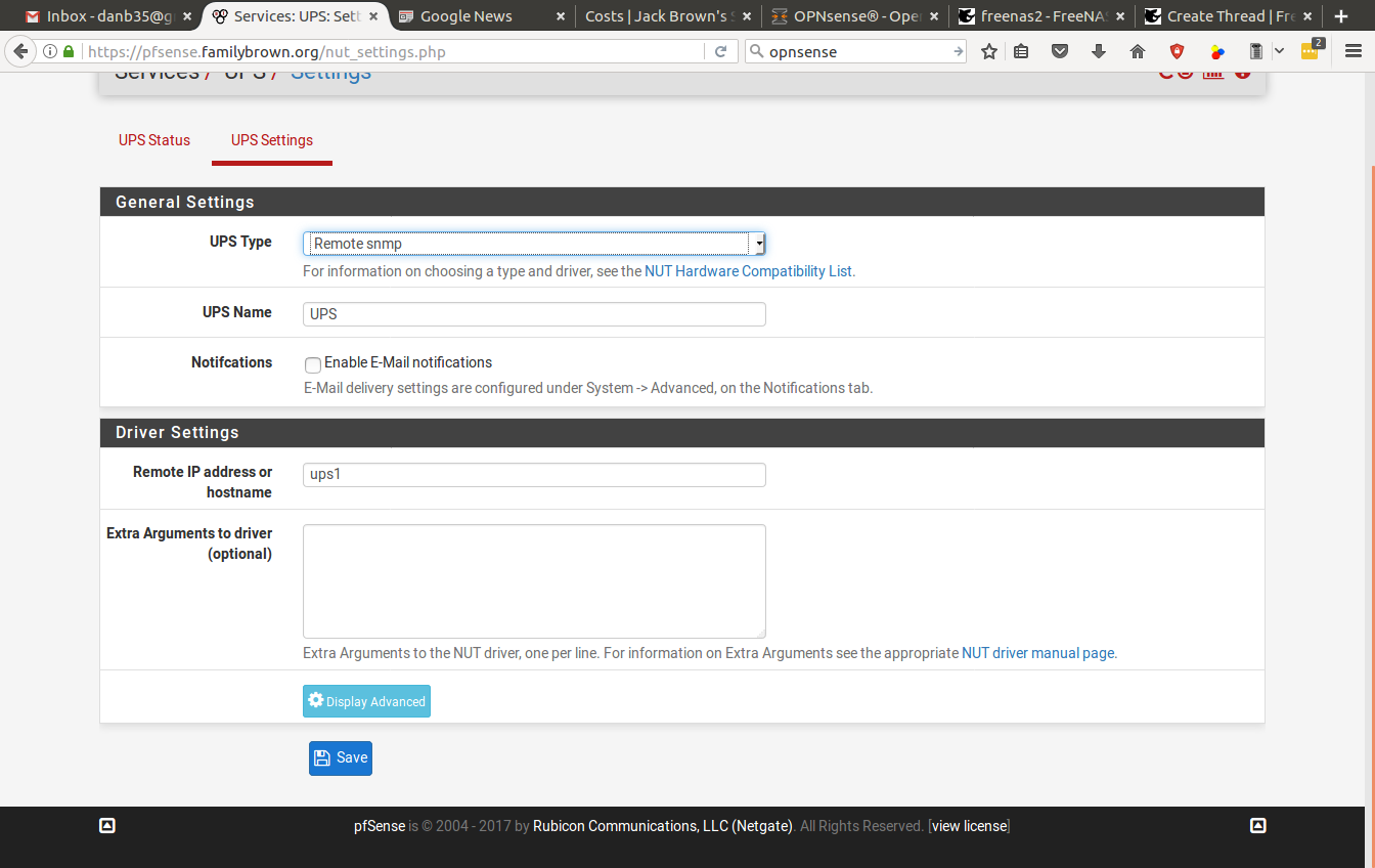

I have an APC SUM3000RMXL2U UPS with a network interface (their model 9631 card), that I'm trying to configure FreeNAS (9.10.2-U2) to use over the network. Under pfSense, configuring this is simplicity itself--"ups1" below is the hostname of the UPS on my network:
...but I'm having trouble finding equivalent configuration options in FreeNAS. Thoughts?

Well, if the docs aren't obvious, Use the Source, Luke. Didn't actually dig that far, but took a look at the ups.conf file that the pfSense box was using, and saw that it used "ups1" as the port.
So, with further poking around, it appears that despite being a drop-down, you can enter arbitrary values in the Port field in FreeNAS's UPS configuration. Entered "ups1" there, chose the snmp-ups driver for the AP9630, and the service starts without an issue. upsc ups@localhost returns a bunch of data that matches the device.
