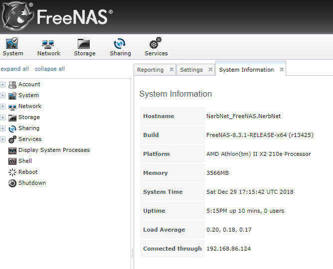

@Chris Moore, thanks for the reply. Yes, it is really FreeNAS 8.3.1 (see screenshot below). I ordered another 4GB of RAM so that I will have the required 8GB for an upgrade. I believe my system should meet the requirements for an upgrade. I have 5x2TB WD Green drives (not the most performant, but use less power) and all are healthy arranged in a RAIDZ cluster with ZFS.
What's the best path forward?
Looking at the logo, that appears to be the iXsystems version of FreeNAS and you should be able to upgrade. The trouble is, there have been many changes over the versions from where you are, to where the current version is, and you would likely not be successful bringing your configuration forward if you try to do it in a single leap.
These upgrades not only upgrade the User Interface (WebUI) they also upgrade the underlying operating system (FreeBSD) and the two things need to work properly together. There are also changes to the format of the database file from back then to now.
I would suggest upgrading first from FreeNAS 8.3.1 to FreeNAS 9.1.x and ensure that all the settings carry forward.
Then you should be able to upgrade from there to FreeNAS 9.3 without any trouble.
Then upgrade from FreeNAS 9.3 to FreeNAS 9.10 and from there to FreeNAS-11.1-U6.3
