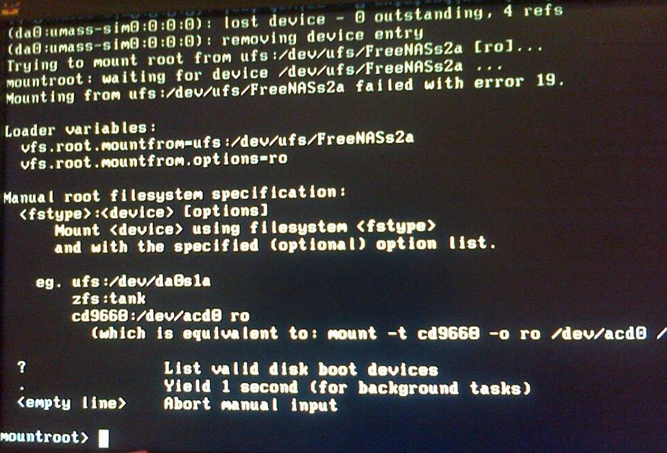

Hi - there. Looking for some help please.
Spec:
Hp Microserver NL40, 4gb ram, 4 gb usb, 2 x mirrored 500gb Western Digital HDD
Server running stable for a year ( 8.3.1 amd 64 bit running on USB drive, no jails used ). Decided to upgrade last night to 9.1.1 but server didnt come back up.
I am currently 300 miles away from the box, but have a non tech helper at the other end :)
Screen grabs of current situation are :
I took a config backup before the upgrade.
Questions:
pretty simple one: What should i do now ?!
Thanks in advance.

First, I'd try a cold system boot.
Second, those errors look like a bad USB stick. So if the cold system boot doesn't fix your problem I'd get a new USB stick, flash it with 9.1.1, then just do a config restore. You did backup your config file before the upgrade just like the manual recommends, right? :P

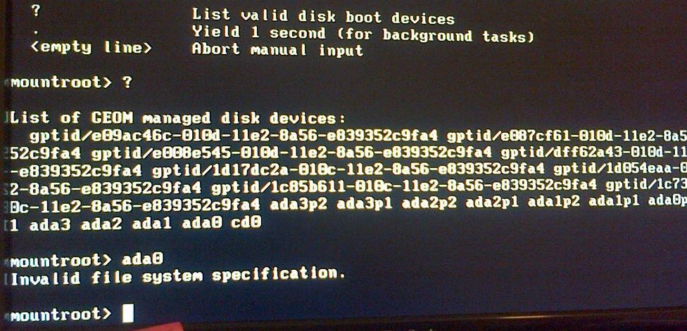

Last questions :)
Why am i not getting the F1/F2 option to load the original OS?
Can i force that from the cmd line / mountroot prompt?
Anything else to try ?
