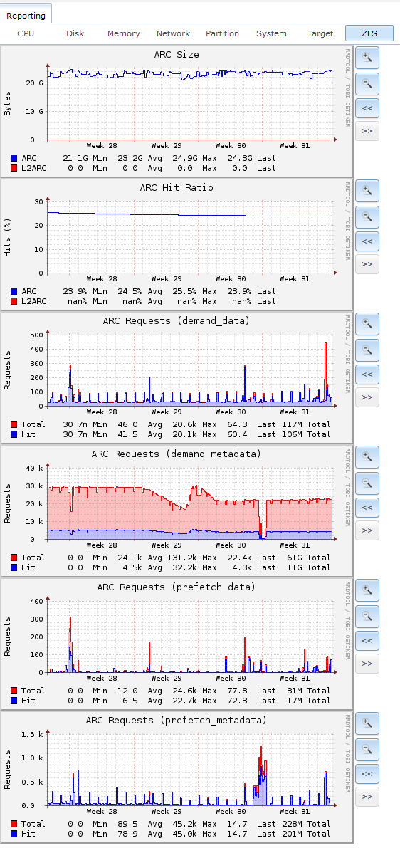

The primary reason for adding RAM is based on my ARC and swap usage, but I am not quite sure if this is so relevant based on the following post:

That's the thing, you're going from a 4 core 3.5ghz+ CPU, to 8 core at 2ishGhz. Marginally faster. The big upgrade is from 32GB max ram to 1TB max ram. And PCIe slots.
The RAM should make a difference as you'll be able to upgrade your ARC and L2ARC.
