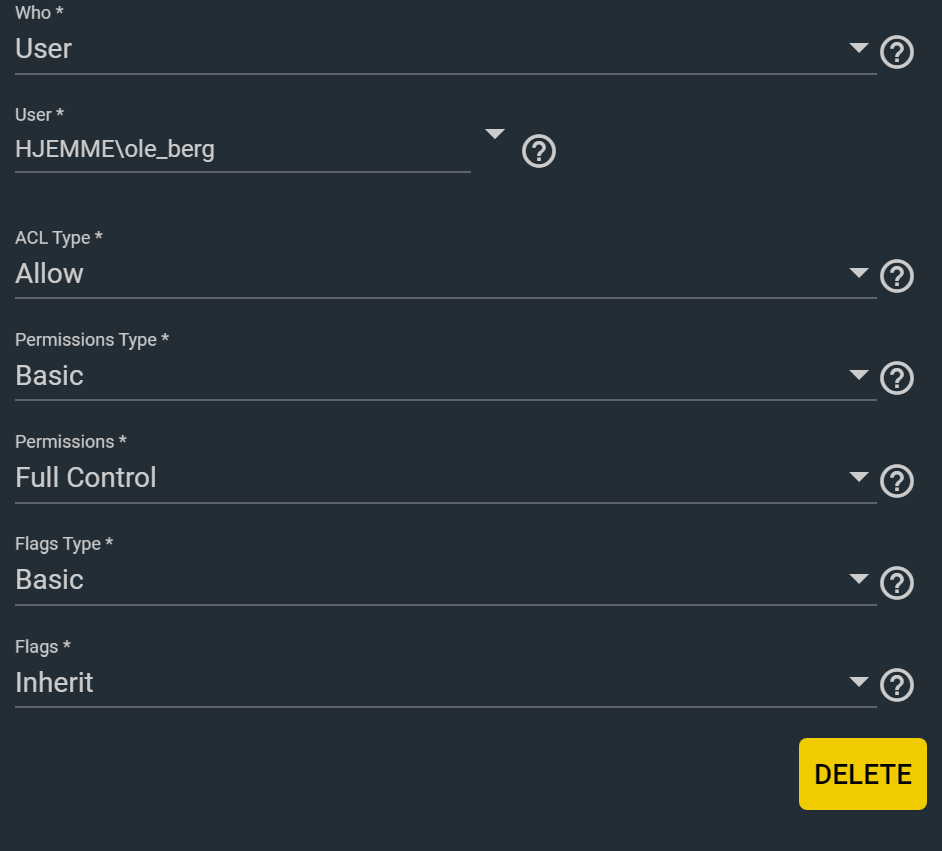

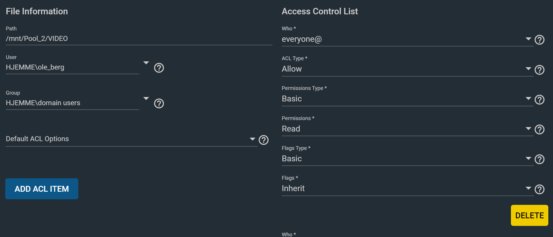

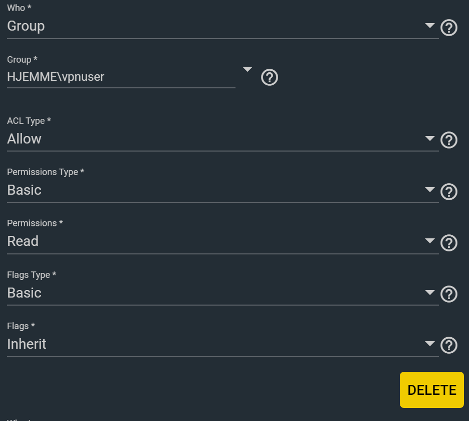

This means you probably have a permissions issue and not an AD issue. Post the ACL for each path component leading to your share.
Elo
Mar 11, 2012
122
Just saw you last post and i will post the ACL settings!
Please find attached info om ACLs for the VIDEO share.
