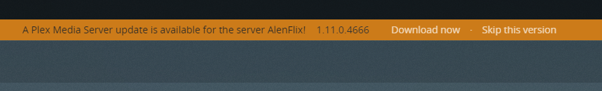

When I restarted Plex and logged into the GUI I saw this:
Looking at the server settings page I see this:
I guess the question is, did the process work or am I missing a step?

Well that would be for the plexpass version of Plex. I'm guessing here but I think you may have broken your ability to update plex by using the updater script since pkg isn't finding any updates. That script was meant to update the plugin version and until very recently in iocage there wasn't a plexpass version of the plugin available.
How did you install plex in the first place? Did you use the tutorial from this forum?
