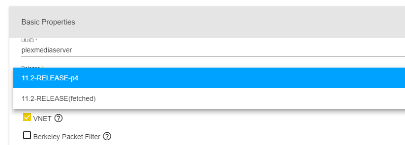

That doesn't seem to be the same issue I'm having, when I run this:
root@plexmediaserver:~ # freebsd-version
11.2-RELEASE-p4
It still shows up with p4 and on my recenltly installed FreeNAS test server I'm on p9.
My FreeNAS server is fully up to date and so is my jail.

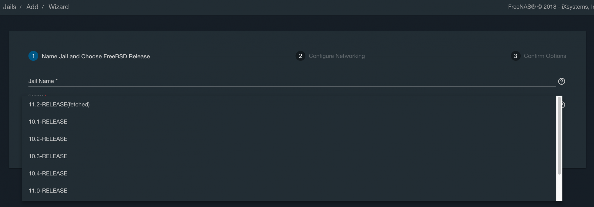

@Mannekino this is what I get:
root@freenas[~]# freebsd-version
11.2-STABLE
[root@plex /]# freebsd-version
11.2-RELEASE-p2
The first command was running from root on the box, the 2nd from within my plex jail.
The WebUI Dashboard reports this as FreeNAS Version: FreeNAS-11.2-RELEASE-U1
I think the issue is that I have not fetched an updated "Release" for iocage:
Anyone know how to download updates for the "Release" menu when creating a Jail?

Yeah, my thoughts exactly. It indeed looks like there is no fetched release for the latest "patch version", is that the correct term?
If I edit my jail I can only select the p4 fetched version. There is no button to fetch a new release. Maybe this can be done from the command line.
