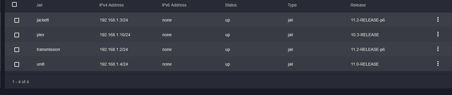

Redcoat
Feb 18, 2014
2,922
I have tried to update my Plex jail today. This was originally a warden jail from "years back" and converted to an iocage jail. It's presently showing to be on 10.3.
I followed the update instructions and selected the latest release, but the update failed.
I tried again with a couple more releases "just for fun": 10.4 and 11.1. Both attempts also failed.
Error messages in all cases were identical - see below.

Mannekino
Nov 14, 2012
332
@rmccullough so are we experiencing a bug or am I doing something wrong? When I ran the pkg update and pkg upgrade last week in my Transmission jail it did do an update but it still shows p4. After the update I lost some of my Transmission settings such as the download directory which I had to re-configure using the sysrc command.
