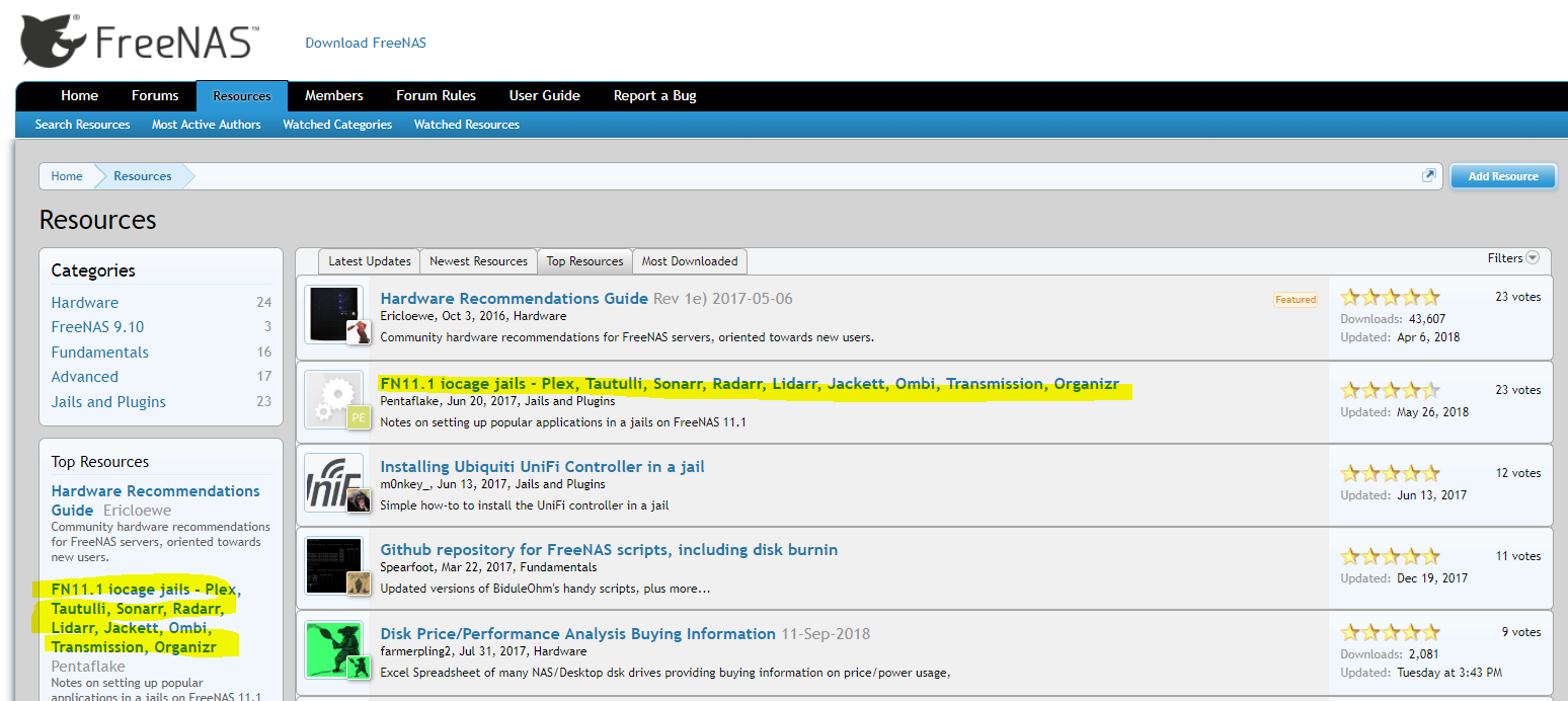

8-bit Yoda
Jun 16, 2018
68
Perhaps it would make sense to sticky a post with links to commonly needed guides
Have you seen the "top resources" in the resources section? Click it and scroll to the "Plex" section.
https://forums.freenas.org/index.ph...lidarr-jackett-ombi-transmission-organizr.58/
Thank you. I haven't seen that. I think it would help to make another category called "Guides".
