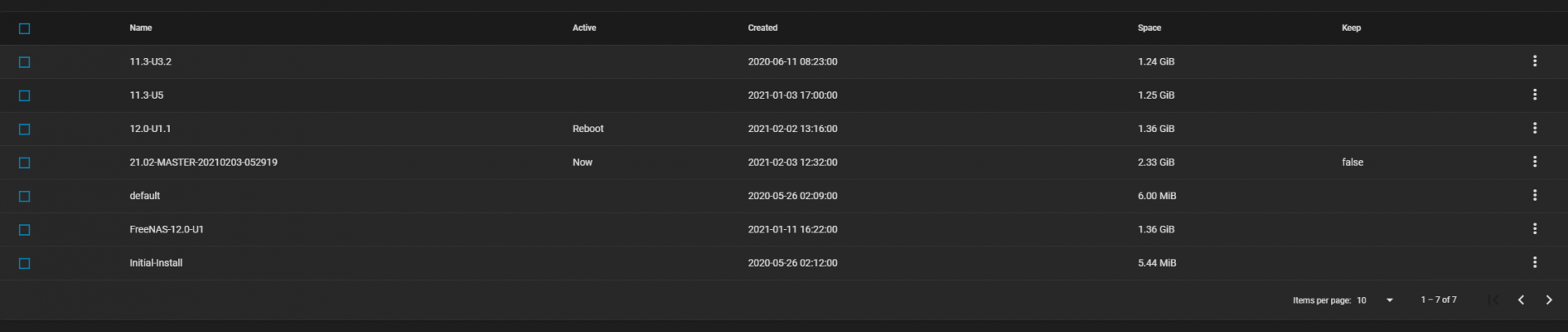

Now at item 5, I was a bit distracted and picked up the wrong tab. I uploaded the update file to system A instead of B.
So, my main system A (formerly TrueNas 12.0-U1.1) is now booting Scale... I am able to login, and I can see the boot environments as well.
I was really suprised to get that far, but nonetheless. I select TrueNas as Reboot, but it always boots scale. I suspect the boot files have been overwritten?
Is there a possibility to remove Scale and get back? Or do I have to reinstall TrueNas from Scratch?

You'll probably have to reinstall. I believe TrueNAS uses the FreeBSD BTX bootloader and Scale uses GRUB, so you've overwritten your boot sector with a new bootloader that didn't know about any of the old boot environments.
