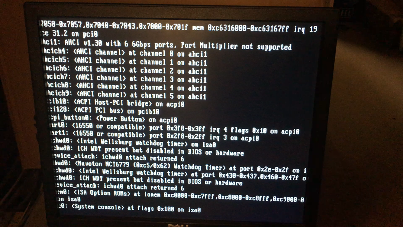

Id like to start by thanking for any help you can give and apologise if i've asked this in the wrong place.
I currently run freenas 9.3 with now no issues (well took lots of reading and learning)
I've tried to update to 9.10. I can successfully update but when it tries to start i hit issues. The machine hits a point on the black load up screen where it just reboots. I've now spent days of trying to read and find out why but with no success. I've Attached a picture from just where it then reboots. Also uploaded a video of it on to youtube so you can see. https://youtu.be/OZ4jL6y0hHc
I've tried fresh copies. Also tried different storage devices for the os.
Motherboard: Asus Z10PE-D16 WS
Ram: ECC Crucial 2x16 DDR4 model ct2k16g4rfd4213
Storage Drives: WD 6TB RED (disconnected in video to see if that was issue)
CPU: 2x Intel Xeon QEYP E5 2658 V3 ES 2.0-2.4Ghz 12 Core 24 threads 30MB 105W LGA2011-3
Boot Device: 2 sandisk 32GB usb's (which ive tried several different things)
Case: lianli-343B
Again many pre thanks. please keep in mind im not very technical but do do my best to learn.
