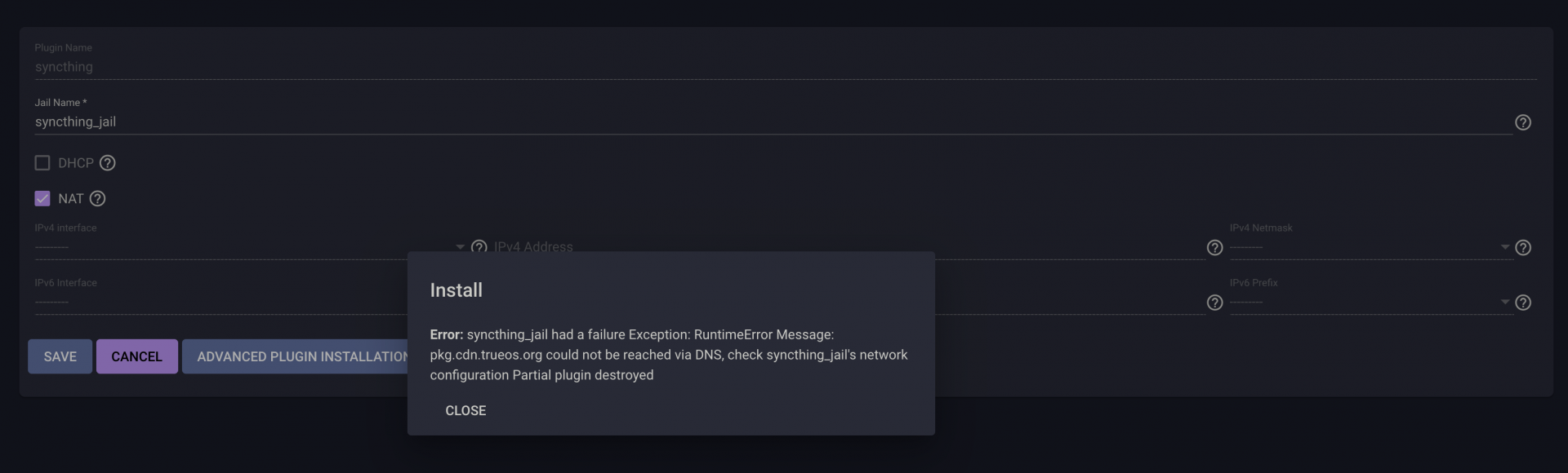

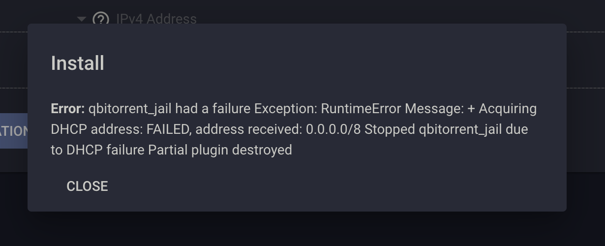

I am a very non-technical user. In my free time I decided to setup FreeNas 11.3. Installed it on a USB and then plugged it to my laptop and had it working.
Had few issues but got over most of them. Currently stuck at unable to install plugins. (screenshots below for syncthing and qbitorrent installation attempts. Note that tried installation with default NAT for syncthing and default DHCP for qbitorrent)

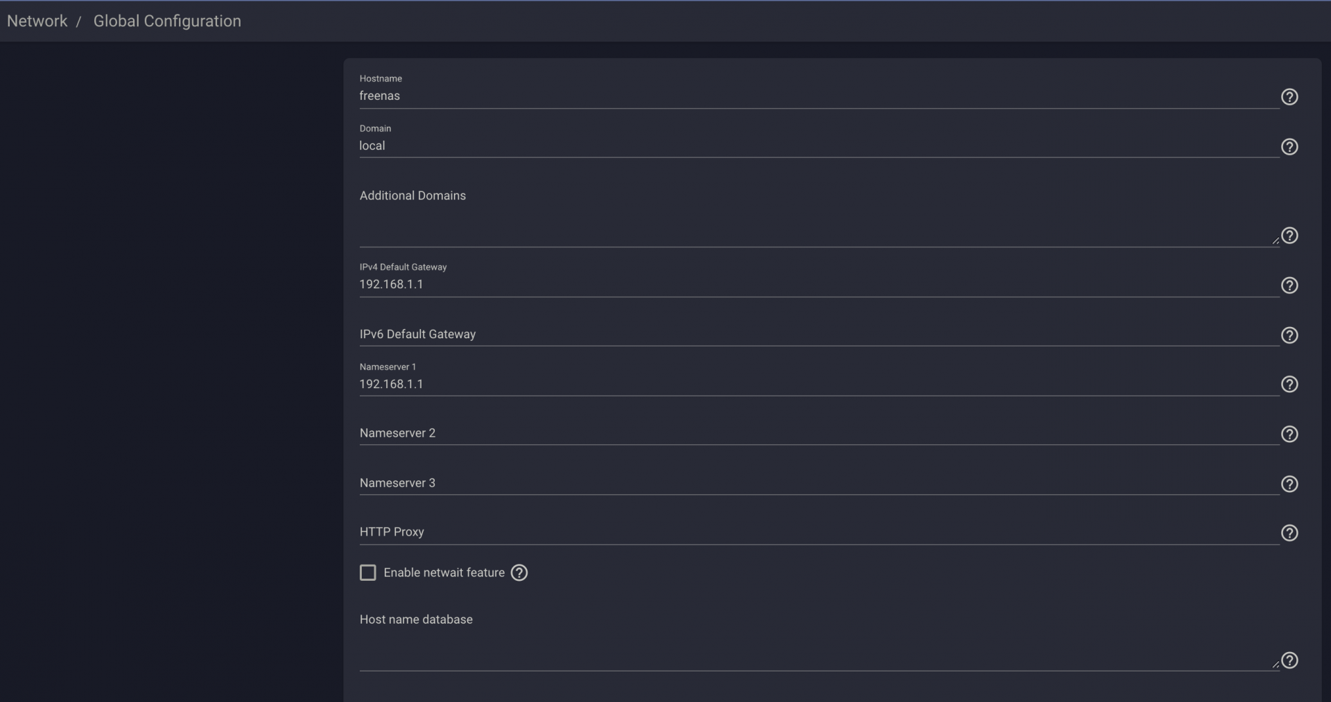

Screenshot for my current global configuration
It seems to me like a network config issue but not sure how to fix it. Note that I have FreeNAS running on 192.168.1.32. Have opened both ports 22 and 21 so can access my external IP with a username/pwd setup under Accounts>Users (also through root). Am also able to ping www.google.com from shell.
Can someone help with the issue.
