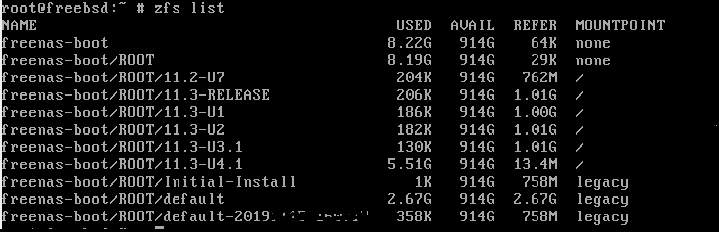

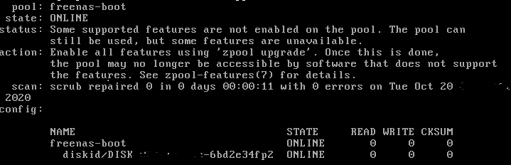

3. Used FreeBSD through LiveCD and also connected NAS boot drive and tried to read existing pool, mount, and copy the old config file. We followed the method from https://gmpreussner.com/reference/recovering-freenas-configuration-from-zfs-boot-drive
Result: I could see the pool online but not the disks listed
zpool status:
zfs list
Able to mount freenas-boot/ROOT/11.3-U4.1 dataset but did not see data folder to copy the config file.
I have tried above process in Ubuntu OS by installing ZFS utils but the output remained same. This is a show stopper for me.

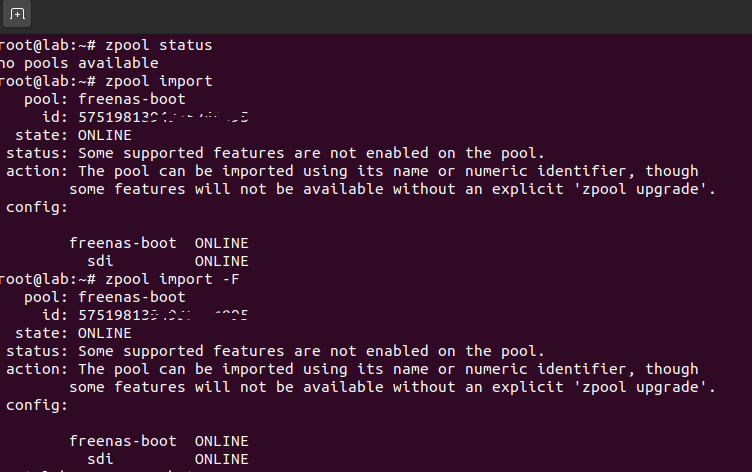

If you issue the command zpool import from the command line, the system should lists pools available to import.
This command searches all devices that the system can see, so if the system does not see a pool to import, you either have no connection to the drives that contain the pool, or the pool is damaged beyond recognition, OR the pool is encrypted...
You might also try using the zpool import -F option as that will attempt to return a damaged pool to an importable state by discarding the last few transactions. Not all damaged pools can be recovered by using this option. If successful, the data from the discarded transactions is irretrievably lost.
No luck, please find below screenshots
Now, what are my odds for restoring the data?

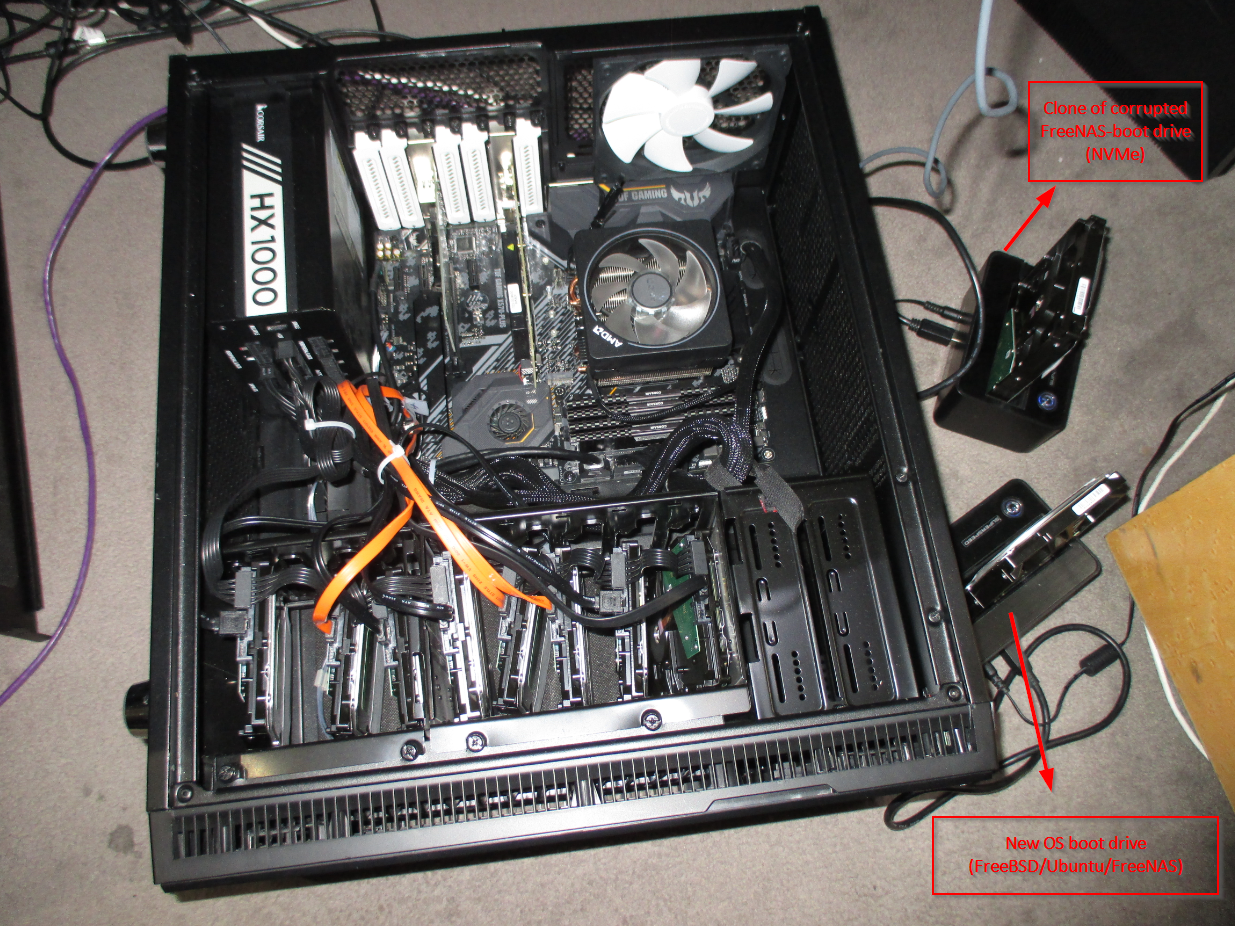

When I look at all those loose disks in the picture, it makes me shudder. Drives are specified for certain positions to operate, which usually means either horizontal or vertical. Having them "fly around" means that they more or less vertical (i.e. not truly vertical), which puts additional stress on the mechanical components and therefore increases risk of failure.
Serious_Sam
Dec 31, 2020
9
Those were not the original disks, they are working copies we are testing in the lab . The originals were placed vertical with each disk supported with small enclosure. However, i am able to detect all the connected drives.

Hi Patrick,
I did try to import pool with FreeBSD 12.2 and also with fresh installation of FreeNAS 11.3-U4.5 and Ubuntu 20.04. All three resulted in "no pools available".
the command i tried:
zpool import
zpool import -f /tmp/freenas
zpool import -d /dev
When i connect the corrupted FreeNAS boot drive, the pool is visible but disks under that pool are not. So, i tried to mount the corrupted FreeNAS to copy over the old config file but the /data folder is missing.
I think we might be having a terminology problem here.
When you attempt to import the pool under FreeNAS, using the GUI, does it find a pool to import?
When i boot the system with new FreeNAS 11.3-U4.1 from different drive i did not find any import pool in GUI.
Next, when connected the corrupted FreeNAS boot drive back along with new boot drive, as shown in above picture setup, I saw freenas-5123903XXXXXXXXX pool item but facing below error that pool already exists with below details.
I think because of new boot drive the old pool is not getting imported? is it possible to call the pool from specific drive?
Perhaps the storage pool was upgraded (feature flags) with a newer version of FreeNAS? Have you tried using TrueNAS Core as the boot media?
