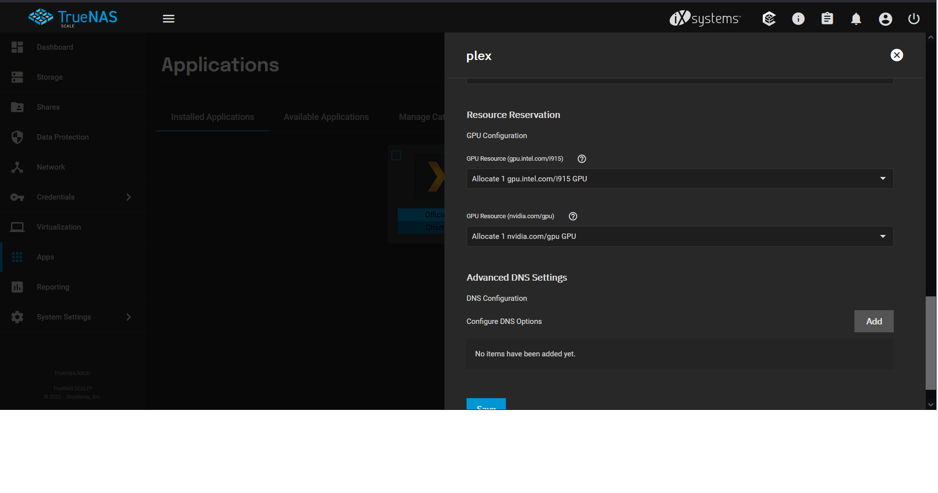

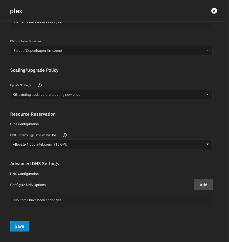

I am also allowed to add iGPU to Plex app (Official Chart):

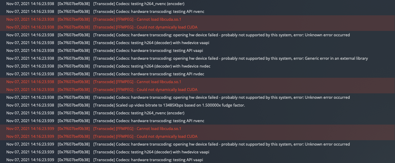

While trying transcode on different movies debug shows only following errors that are related to CUDA. I do not have nor had nvidia GPU in the system and it suprises me that there is random CUDA error:
One thread suggested that OS does not see iGPU and it disables the plugin (case with BMC graphics) but in my case it seems to be fixed as intel-gpu-plugin is running.

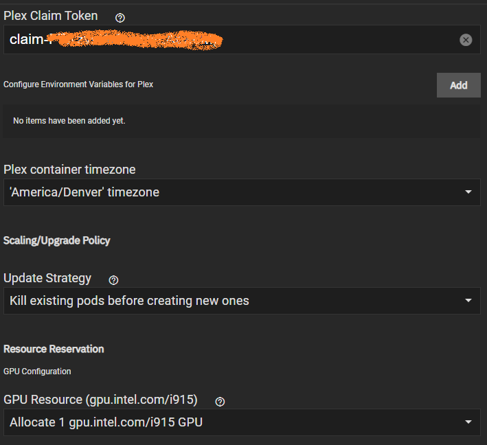

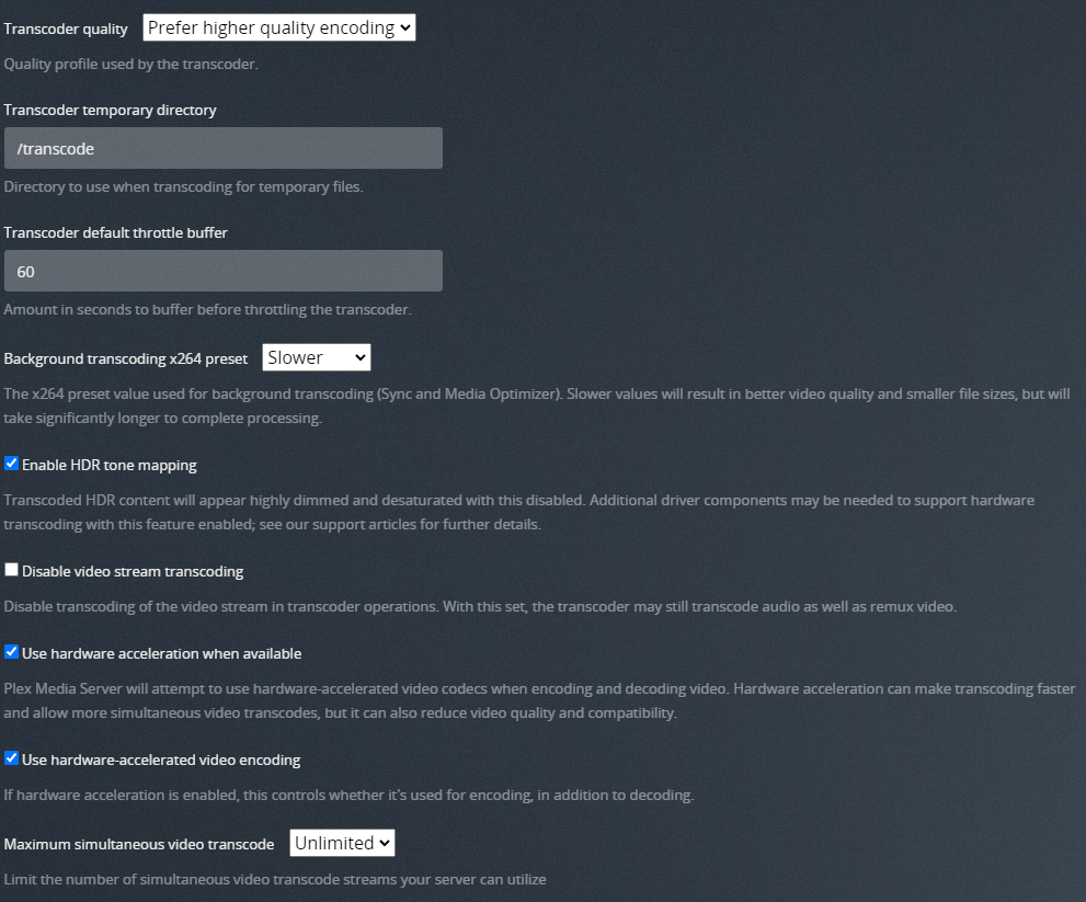

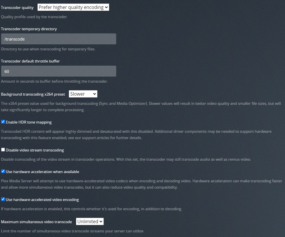

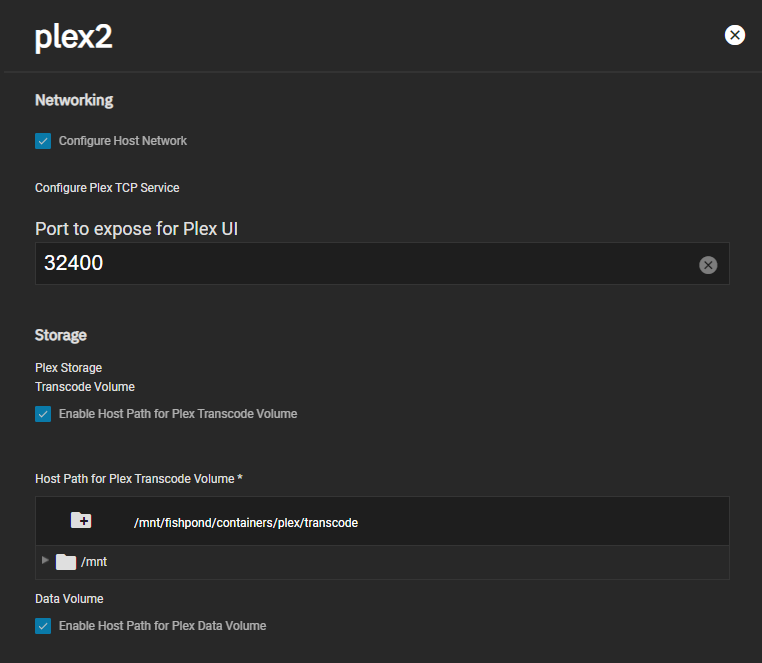

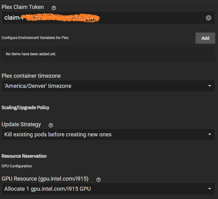

I had a lot of problems getting Plex hardware transcoding working in Truenas Core, so I recently upgraded to Scale where the HW transcoding started working right away. I would love to help, but I don't know enough about Docker or Scale or Linux to drive the troubleshooting forward. So if you can send me linux commands to try, I can send the results back and we can compare results.
In the meantime, here are some screenshots from my setup, maybe they will help:

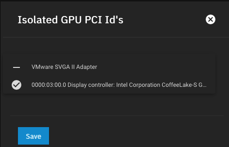

I think option "Isolated GPU PCI ID's" it's for VM on TrueNAS not for Apps.
If you unselect "Intel Coffelake" in "Isolated GPU PCI ID's", after reboot, you can activate you Intel Card on Plex Apps.

Yea. That is how I've set it up but still I have only CPU transcode. HW part of it doesn't want to kick in :/
I removed it from Isolated GPU and rebooted the VM but still it doesn't work
