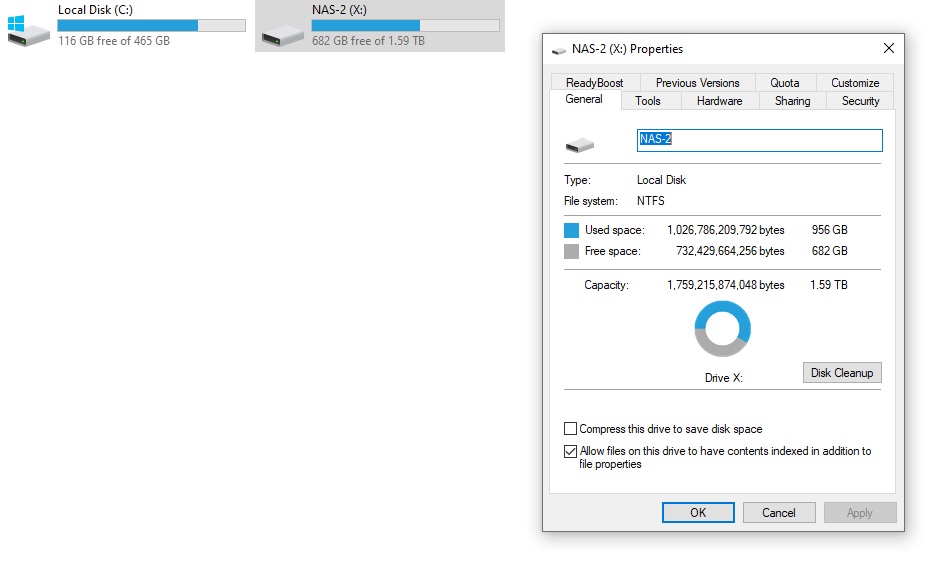

From the ISCSI view there is 640GB of 1600GB free (see my misprovisioning?) I used way more than 50% of what was available.
Freenas shows 1.6GB used and 134GB available..
Just from those numbers and no experience I'd think my one and only snapshot should work.
