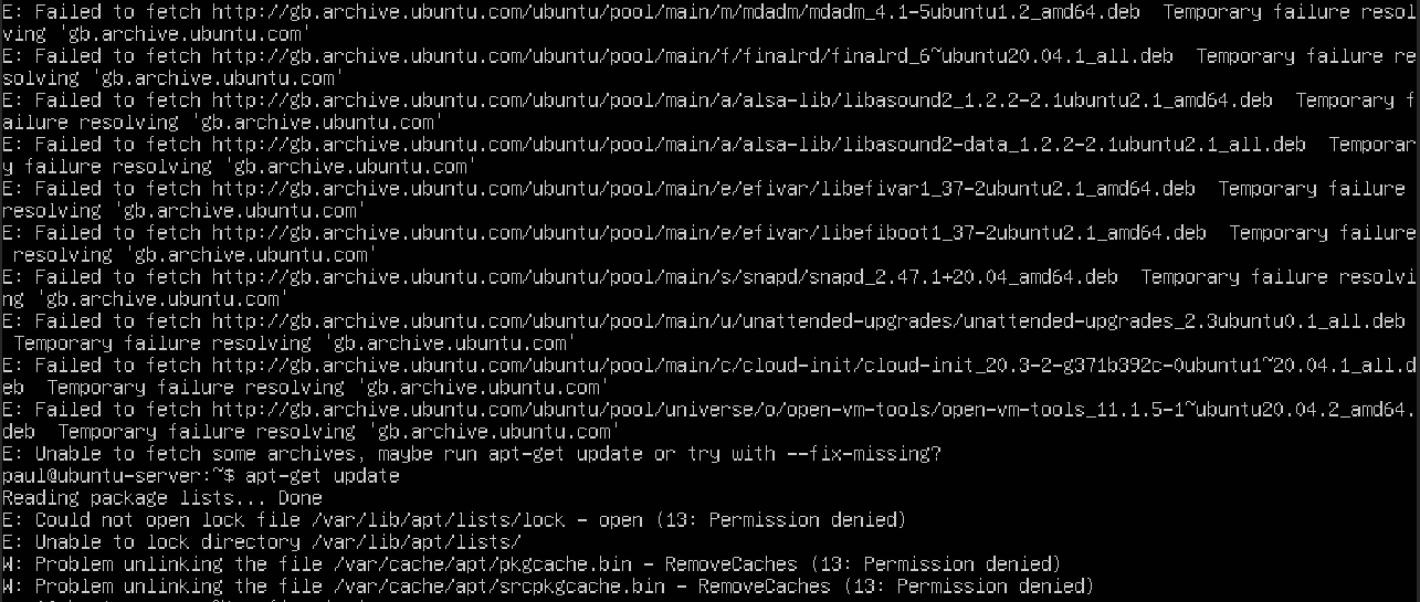

I am struggling to install Ubuntu server on FreeNAS-11.3-U4.1 , to be more precise I think the NIC isn't being passed through. Does anyone have a guide on this.
What I am seeing is a blank config file etc/network/interfaces.
when running apt-get update i am seeing packages not resolving
if I try and ping google Its non responsive

Cook1e_mr
Jul 30, 2020
13
I should also advice that I am unable to view ifconfig as the server tells me it's not installed but the required apt-get wont resolve.
I have added this as I'm sure that someone may ask what's in the ifconfig

Hi All
I worked out what my issue was, i will share in the hope that it helps others. The issue I had was with the install, I could not eject the install media in bhyve. To get around this, I was removing the CD-ROM under devices. This was inadvertently reordering my devices and changing the NIC mapping within ubuntu.
I solved this by adding the VM within the dashboard and before booting the installation media, reordering my devices so that the CD-ROM was the last device.
Therefore when I removed the CD-ROM device before restart after installation. The other devices stayed in the original positions.
