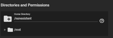

In the profile of a user, when you assign him his main directory.
If Paul is the owner of the TOTO dataset, I noticed that I could also assign the TOTO dataset as the main dataset to Peter.
I hope I was more explicit.

Hello,
Yes, that's what I thought at first.
In the web interface, when I assigned the "TOTO" directory as "main directory" to Peter, Truenas did not throw me out. He should have warned me that this dataset already had an owner.
Or, he de-assigned Paul's "TOTO" to Peter's profile record. But when I went to Paul's profile, "TOTO" was still assigned as Paul's "main directory".
I have not yet gone to see (in command line) who was the real owner of the "TOTO" dataset.
But in the web interface, there should be an "alert", because visually in their respective profiles, peter and paul are both owners of "TOTO".

Hello,
I have done some tests.
Indeed, by doing an ls -l on the datasets, the owner has changed. But in the web interface, when you go to their respective profiles, Paul and Peter are both "owner" of the same dataset "TOTO". A restart of the server is not enough to update the right parameters.
Be careful who is the owner, because as in my case, it played tricks for my ssh connection.
To redefine the initial owner (without going through the command line), you have to unlink the two users defined on the same dataset (for example by putting them in /nonexistent), and only then redefine the initial user.
