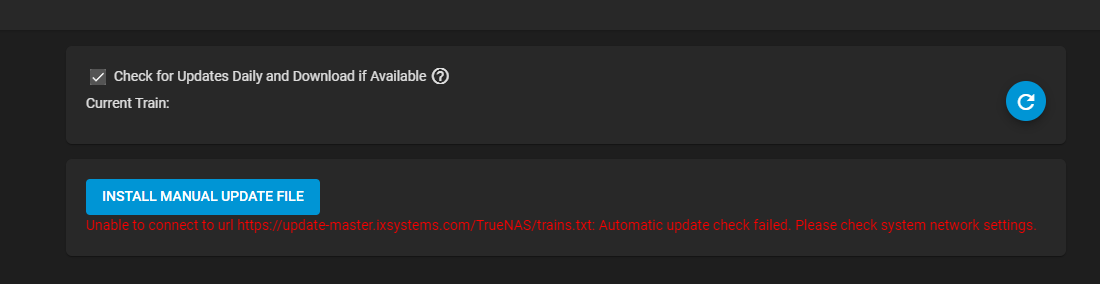

I get this error if I try to manually check for updates...

Then please check your system network settings ... :smile:
Post a screenshot of Network > Summary if you need assistance.
