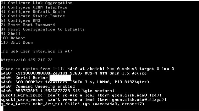

Hi all.
So i am moving over from a synology nas to truenas. My home server is running XCP-NG, the truenas VM has a dedicated NIC and SATA HBA card* passed over to it. Both shows up when i run "pciconf -lv". The drive works perfectly (verified on a different machine) but i cant see it in the GUI. I pulled out the disk then after the disk spun down i pushed back in, and low and behold i see this in the console:
Google did not help me so i would appriciate any help.
Thanks in advance!

You shouldn't use external sites for pasting screenshots, this forum can take them directly and it's nicer for those who read things here to see without needing to leave the site.
I would suggest you may have a conflict with the way you're assigning the boot drive from XCP... are you also using a virtual SATA adapter for that? (and do you have an alternative or the option to specify the controller or disk IDs?)

Ok, sorry about that. Its a habit i guess, many forums wont take pics for some reason.
Yes, the drive for the OS is virtual, there is no advanced options for it in XO.

Do you have the option to offer the OS drive as SCSI instead of SATA? That should land it as da0 rather than ada0, so maybe avoid the conflict.

No, i can only add new virtual disks but i cant set whether it will show as sata or scsi for the guest OS.....

It is a problem of Xen block driver, pretending it is regular SATA, but since it is not coming through CAM subsystem it result sin conflict. As one of possible solutions you may force different ada device numbers to SATA ports on passed-through HBA. Look `man 4 cam` for description and examples.

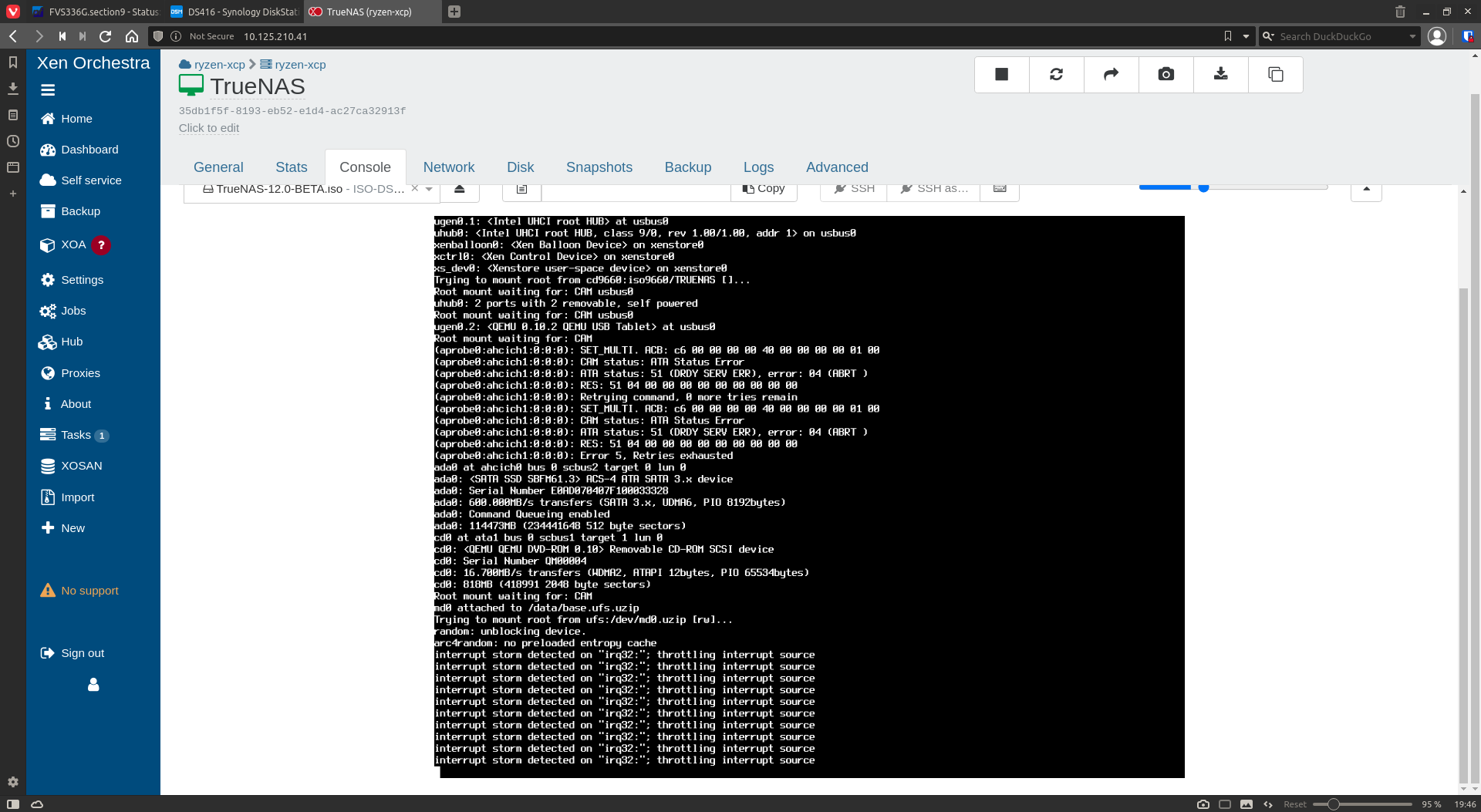

Just to test i put in an ssd and hooked it up to the sata card but i still get interrupt storms during install even though the xcp-ng virtual disk is gone.......
(killed VM during install and rebooted the host to make sure its not caused by hot plugging sata, the storm seems to come from irq32)
/EDIT
QUick and dirty fix, added
hint.ada.0.at="scbus200"
to /boot/device.hints which fixed the ada0 issue, but i still get storm from irg36...... (one cpu core is pinned at 100% all the time) Cant see the ssd either under disks in the webui. Extracted from bootlog:
xn0: <Virtual Network Interface> at device/vif/0 on xenbusb_front0
xbd0: 65536MB <Virtual Block Device> at device/vbd/768uhub0:  on xenbusb_front0
xbd0: attaching as ada0
xbd0: <Intel UHCI root HUB, class 9/0, rev 1.00/1.00, addr 1> on usbus0
features: write_barrier
xn0: Ethernet address: a0:36:9f:8a:e8:5f
xbd0: synchronize cache commands enabled.
xenbusb_back0: <Xen Backend Devices> on xenstore0
xenballoon0: <Xen Balloon Device> on xenstore0
xn0: backend features: feature-sgxctrl0: <Xen Control Device> feature-gso-tcp4 on xenstore0
xs_dev0:
<Xenstore user-space device> on xenstore0
Trying to mount root from zfs:boot-pool/ROOT/default []...
Root mount waiting for: CAM usbus0
uhub0: 2 ports with 2 removable, self powered
ugen0.2: <QEMU 0.10.2 QEMU USB Tablet> at usbus0
(aprobe0:ahcich1:0:0:0): SET_MULTI. ACB: c6 00 00 00 00 40 00 00 00 00 01 00
(aprobe0:ahcich1:0:0:0): CAM status: ATA Status Error
(aprobe0:ahcich1:0:0:0): ATA status: 51 (DRDY SERV ERR), error: 04 (ABRT )
(aprobe0:ahcich1:0:0:0): RES: 51 04 00 00 00 00 00 00 00 00 00
(aprobe0:ahcich1:0:0:0): Retrying command, 0 more tries remain
(aprobe0:ahcich1:0:0:0): Error 5, Retries exhausted
ada1 at ahcich0 bus 0 scbus2 target 0 lun 0
ada1: <SATA SSD SBFM61.3> ACS-4 ATA SATA 3.x device
ada1: Serial Number <redacted>
ada1: 600.000MB/s transfers (SATA 3.x, UDMA6, PIO 8192bytes)
ada1: Command Queueing enabled
ada1: 114473MB (234441648 512 byte sectors)
cd0 at ata1 bus 0 scbus1 target 1 lun 0
cd0: <QEMU QEMU DVD-ROM 0.10> Removable CD-ROM SCSI device
cd0: Serial Number QM00004
cd0: 16.700MB/s transfers (WDMA2, ATAPI 12bytes, PIO 65534bytes)
cd0: Attempt to query device size failed: NOT READY, Medium not present
