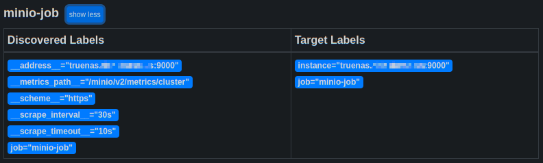

  10. My existing Prometheus scrape jobs resumed scraping against the replacement with no changes needed.

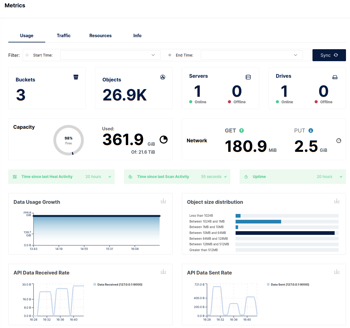

  11. I was able to connect MinIO to Prometheus as well to get better dashboards within MinIO (this was something I could not get working with the S3 Service)

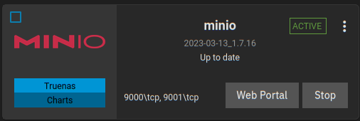

Apps > Search “Minio” > Click [Install].
  • Application Name: Minio
    • Version (whatever is latest) [1.7.15]

I was able to access the MinIO GUI via TrueNAS host IP address on the port I specified (http://192.168.10.102:10002/login)

Once added to Prometheus, you should see the scrape job listed in Prometheus Service Discovery:

Log into the MinIO GUI and navigate Monitoring > Metrics and enjoy your Eye Candy.

Save. Wait a few seconds:
# k3s kubectl get pods -n ix-minio
NAME                     READY   STATUS    RESTARTS   AGE
minio-757bb4cd5f-zxrsv   1/1     Running   0          76s
TrueNAS reflects it too:
