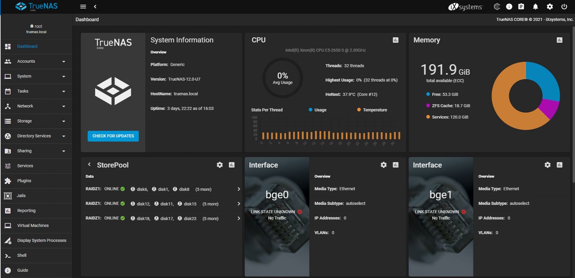

DL360 Gen8 used two SSD 120 disk in Raid 1 configured on P420i Raid Card, have attached Storage Array using HP220 Card in IT Mode
