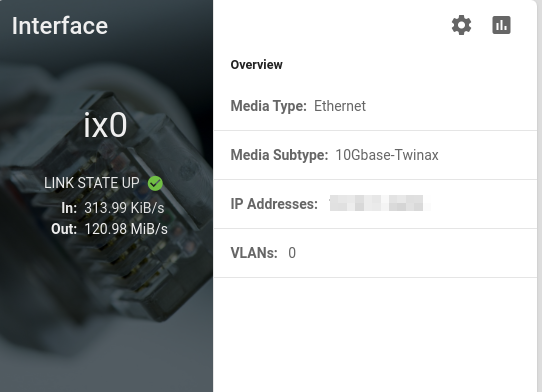

Hey there,
i tested and googled some settings and got a little push up for write/read performance but its not that good.

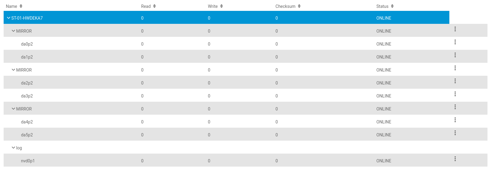

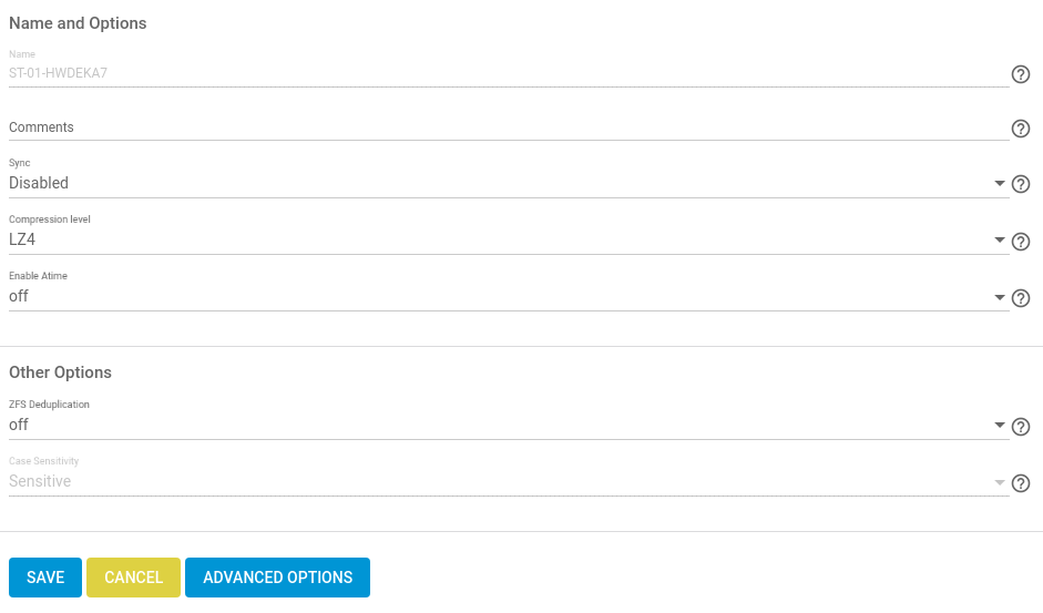

Pool-Settings:
Sync Disabled was for testing normally its set to "always"

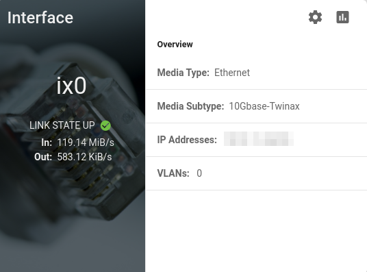

Network/Interface at test:

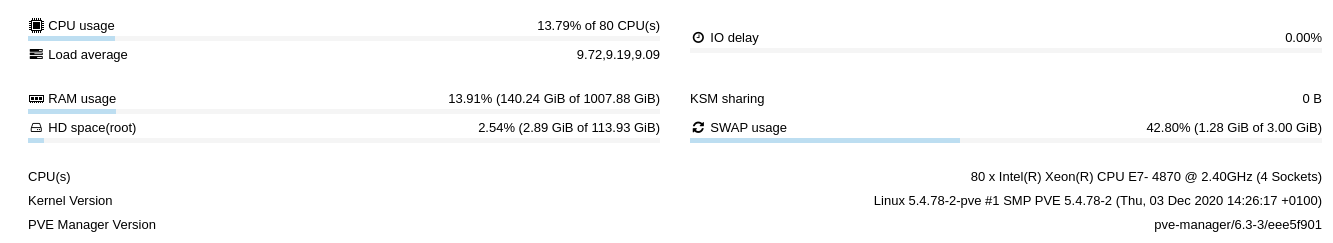

ProxMox Server:
Uses a Dual Port 10Gbe-LAN SFP+ too
Storage is via NFS connected but tbh my write/read is pretty slow.At the TrueNAS Server is the whole VM saved. (VZDump,ISO,Disk Image, Container)
Switch:
UniFi Switch 16XG 10G 16-Port
https://www.notebooksbilliger.de/ubiquiti+unifiswitch+16+port
IOzone: https://pastebin.com/KLC1VvNV
TrueNAS dd test:
dd if=/dev/zero of=/mnt/ST-01-HWDEKA7/st1-proxmox-vms/test.dat bs=2048k count=1000010000+0 records in10000+0 records out20971520000 bytes transferred in 7.992925 secs (2623760479 bytes/sec)
[~]# dd of=/dev/null if=/mnt/ST-01-HWDEKA7/st1-proxmox-vms/test.dat bs=2048k count=1000010000+0 records in10000+0 records out20971520000 bytes transferred in 3.901468 secs (5375288884 bytes/sec)
iperf from ProxMox to TrueNAS:
iperf from TrueNAS to ProxMox:
Don't know why it is just 1.7 Mbits/sec!!

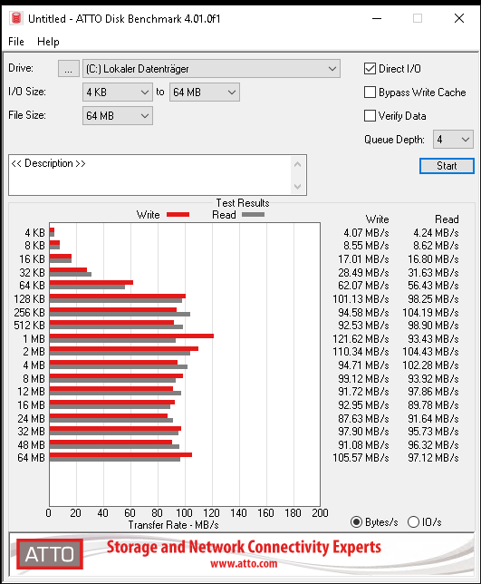

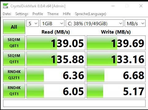

This was tested at a Windows VM:

Everything to the TrueNAS Storage has up to 8/9 Gbits/sec but from the TrueNAS Storage to ProxMox or the VM's its just 1.7 mbit/s
