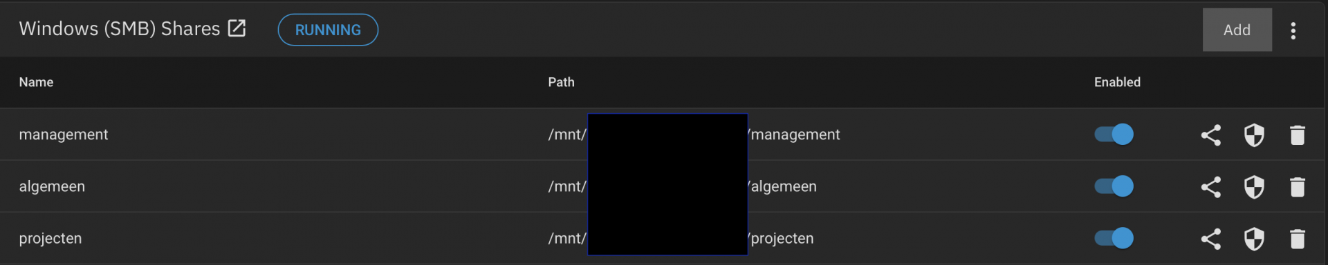

We have a few active shares on our TrueNAS box, in this example we'll just refer to our share as the 'projects' share.
We have a dataset which is called 'projects' as well, so in this case the full path to that might be: /mnt/Pool1/shares/projects
Both the shares and projects datasets are set to SMB.

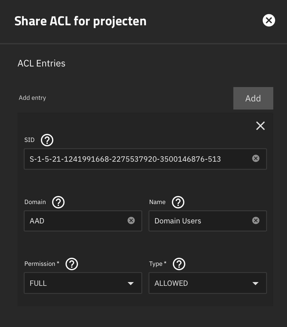

In our SMB ACL we have one entry, granting everyone in the Domain Users group modify access.

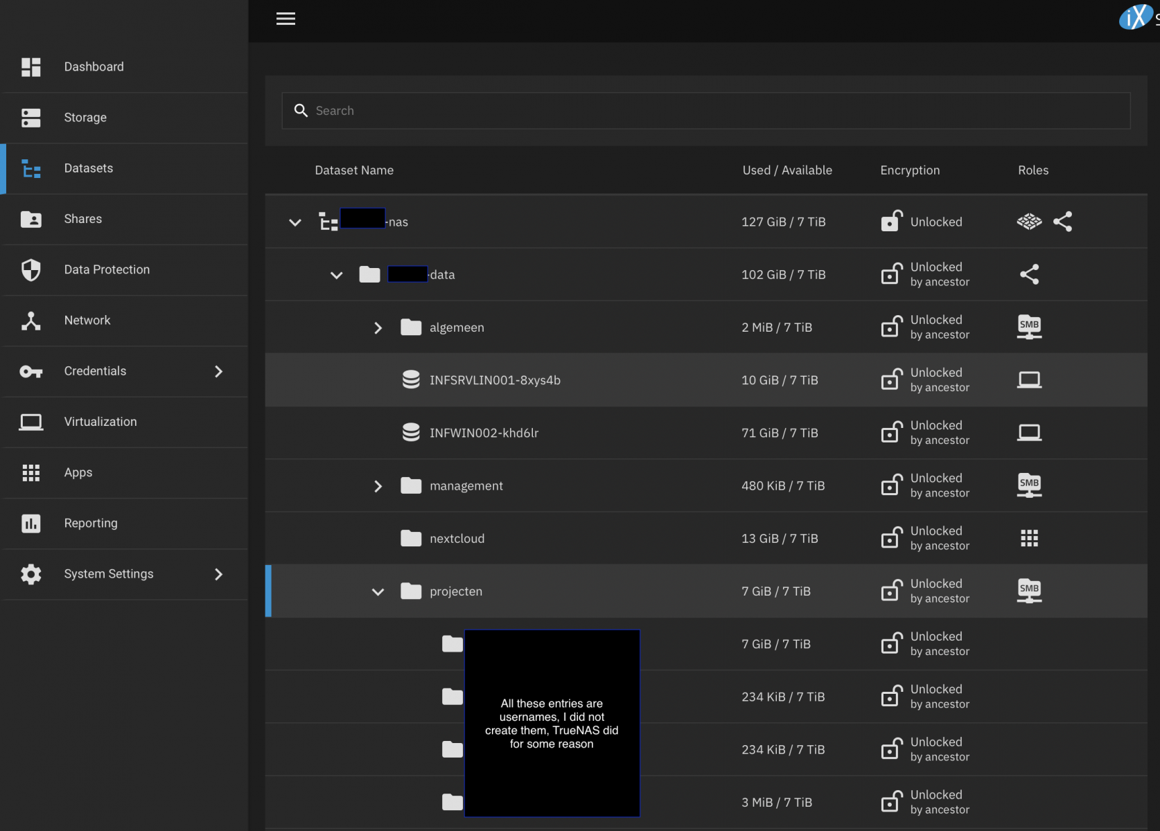

We initially set this up and all access and authentication seemed to be working fine, until one of the end users reported that they can't see files others created on the share.
Upon investigating, we discovered that somehow TrueNAS is making some sort of "user directory" below the share path, and mounting that as the root of the share.
So now, the users that mounts [ICODE}\\truenas\projects[/ICODE] will not mount /mnt/Pool1/shares/projects but /mnt/Pool1/shares/projects/username/ - it's even listed as a different dataset in TrueNAS, which leads me to believe this is some kind of TrueNAS specific behaviour. I just can't find out what's causing it.

9,700
What is probably going on is that you selected the "Purpose" of that share to be "Private SMB Datasets and Shares". (the important word there is Private... to each user)
You should select "Default share parameters" instead and customize as needed.

Right! That is true, I didn't realise that had such an impact.
It fixed my issue indeed, thank you!
