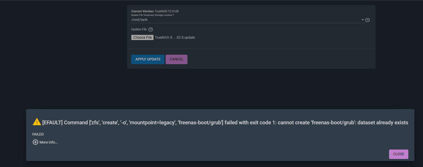

Hi everyone ... before I move forward ....
Running CORE 12.0-U8.
Did the manual update from the GUI per the instructions here.
Got through post-install tasks and then threw this "failed" error
File "/usr/local/lib/python3.9/site-packages/middlewared/job.py", line 367, in run
await self.future
File "/usr/local/lib/python3.9/site-packages/middlewared/job.py", line 403, in __run_body
File "/usr/local/lib/python3.9/site-packages/middlewared/schema.py", line 975, in nf
File "/usr/local/lib/python3.9/site-packages/middlewared/plugins/update.py", line 389, in file
await self.middleware.call('update.install_manual_impl', job, destfile, dest_extracted)
File "/usr/local/lib/python3.9/site-packages/middlewared/main.py", line 1256, in call
return await self._call(
File "/usr/local/lib/python3.9/site-packages/middlewared/main.py", line 1224, in _call
File "/usr/local/lib/python3.9/site-packages/middlewared/main.py", line 1128, in run_in_executor
File "/usr/local/lib/python3.9/concurrent/futures/thread.py", line 52, in run
File "/usr/local/lib/python3.9/site-packages/middlewared/plugins/update_/install_freebsd.py", line 53, in install_manual_impl
return self._install_scale(job, path)
File "/usr/local/lib/python3.9/site-packages/middlewared/plugins/update_/install_freebsd.py", line 73, in _install_scale
return self.middleware.call_sync(
File "/usr/local/lib/python3.9/site-packages/middlewared/main.py", line 1283, in call_sync
return methodobj(*prepared_call.args)
File "/usr/local/lib/python3.9/site-packages/middlewared/plugins/update_/install.py", line 69, in install_scale
raise CallError(error)
middlewared.service_exception.CallError: [EFAULT] Command ['zfs', 'create', '-o', 'mountpoint=legacy', 'freenas-boot/grub'] failed with exit code 1: cannot create 'freenas-boot/grub': dataset already exists
It is not the same as my previous VM testing GRUB install error NAS-112296 ... before I do anything else ... thoughts on how to proceed?
Can provide any further info as necessary

@Kris Moore yes I can do that ... is the system in an unstable boot state or did it not complete the update? What happens if I click on the "close" button on that error and what happens if the machine reboots for any reason? Doesn't reboot except for system upgrades...last one was for the 12.0-U8 update.
I created a config backup prior to kicking off the upgrade so I suppose worst case I reinstall 12.0-U8 and restore the config?
